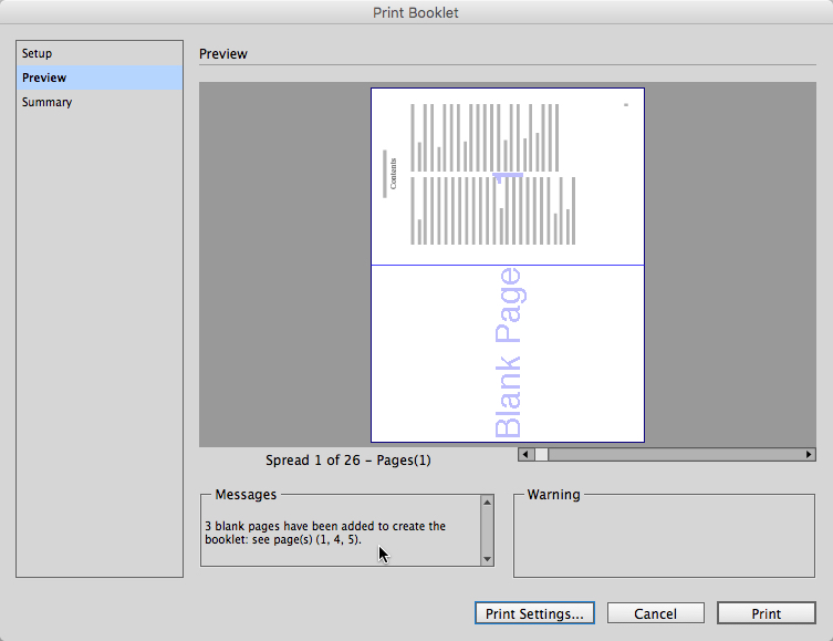

3) When you're ready to produce your booklet, you can use the Print Booklet function to build your printer's spreads, like the example below:
You'll realize from the subsequent comments that will undoubtedly follow this one, that using this function is somewhat controversial. By my experience, it works pretty well. Select the File>Print Booklet... menu command to open this function.

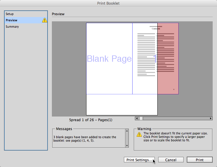

4) I'm going to use a poetry book I'm producing for a client, laid out in letter-half format, for my examples here. It's currently at 49 pages, so I'll have to add a minimum of 3 pages to meet the multiples of 4 rule outlined above. Set the Booklet Type: options box for 2-up Saddle Stitch, then click the Preview option to the left to see how your book will be produced. By default, the previous dialog box showed the default printer you use. It uses the default settings you have set up on your system. Most likely, they'll have nothing to do with how you want to produce your booklet. As illustrated below, mine doesn't either.
You have to fix that. Click the Print Settings... button, as shown above.

6) This returns us to the Preview proxy. It's automatically entered the three extra pages for me in what InDesign considers the least intrusive options; the back cover, inside back cover, and the last facing page inside the back cover. It's also transformed your booklet into conventional printer spreads -- page numbers add up to one more than the total number of pages (for our now 52-page book, 6-47, 46-7, 8-45, etc.) with the odd-numbered page to the right of each spread. If you were going to print the book directly from here, you'd be good to go.
This wouldn't work for me, because I'd want to put the blank pages in different positions. That's why I recommend that you insert the blank page positions manually. But for the sake of this lesson, we'll accept those positions as is.
But you want to see it before you print it. That's smart, but it requires us to click the Print Settings... button one more time.Print Booklet 1c.jpg
