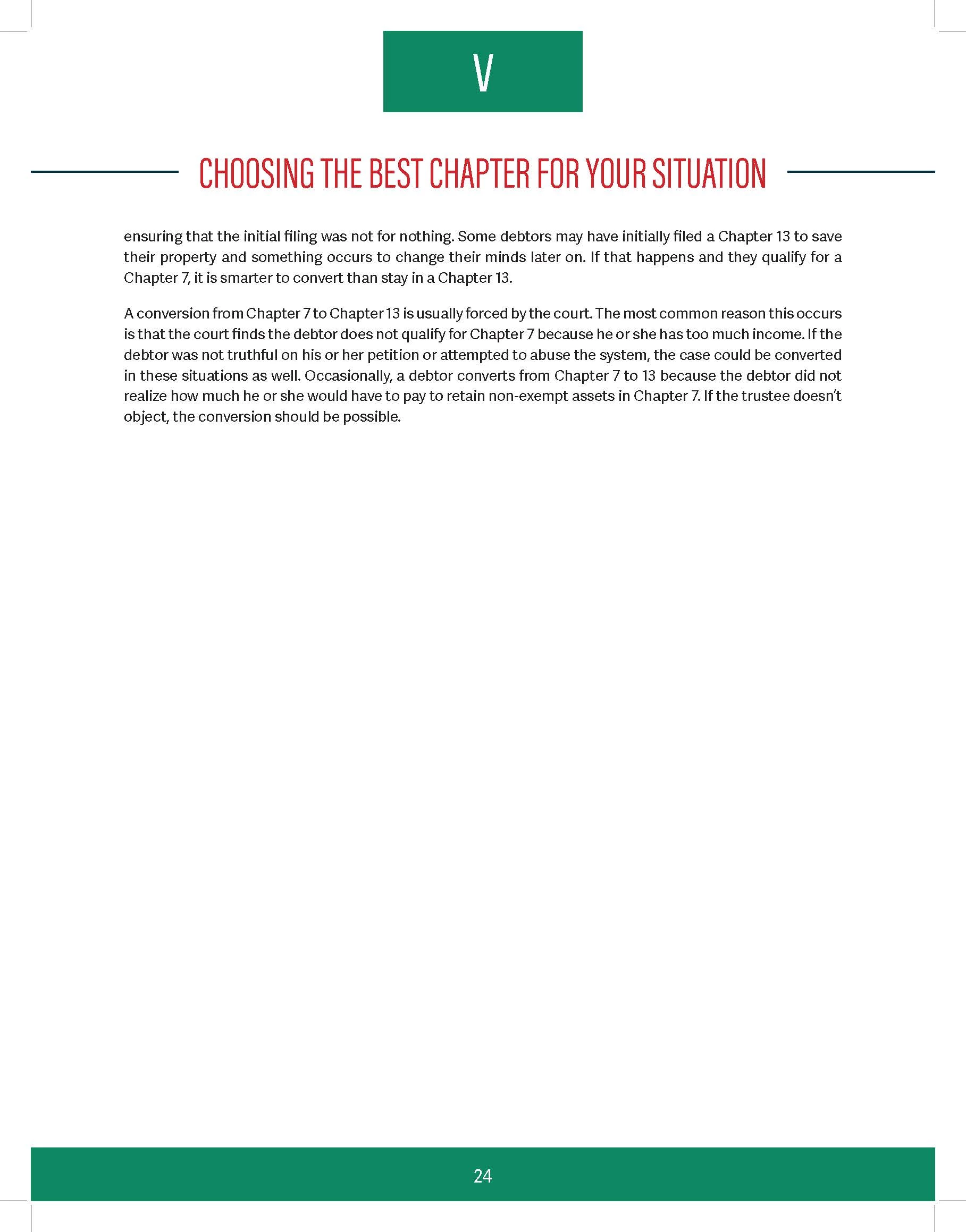

So we have pdf documents that have multiple pages that we've imported into indesign using multiple page script.
I haven't been able to figure out to export the document with bleeds that are usable for print. When import the pdf's, it imports the whole page as a single object, so I can't transform anything without it messing up the text, etc.
Any ideas?
I've included an image of how it exports.

In addition to the good information above, I would ask for a new PDF, correctly exported with bleed, although in my experience the response is likely to be "can you please fix it"?
If you have PitStop, you can create bleed where none exists, or if the PDF was created in Illustrator, you may be able to safely open it and fix the bleed, if not, then John's suggestions are your best option.
Edit, you can also place a 2nd instance of the PDF on the page, slightly enlarged and cropped, to add bleed.

There's no way to manufacture bleed from the placed PDF (images) which have none. I don't know if the example you showed is typical of all the pages, but to add bleed to the example:
  • Determine what color green that is
  • Make new elements (simple rectangles in this case) filled with that green and extend them into the bleed area
It would be great if the green is a known spot color and a reliable match meant you could put the new bleed-extended elements behind/under the placed PDF. But if that's not the case, a near-match could force you to put the new elements in front of/above the placed PDF, and you'll also have to replicate the numbering.

That's what I thought.
I had another idea of being able to scale the object to 101% - then "transform again" all the other pages.
The problem is I was unable to figure out how to center all the objects.
Would that work?

I tried to export it but no matter the scale or percentage i put it in - it still cuts the bleed right at the crop mark. Am I exporting it wrong, or is there something I need to do to recognize the expanded object?
Before you try it again, go to File > Document Setup > Bleed and Slug > Bleed and enter a bleed amount. an eighth-inch or 3 mm should be enough.
Then, when you export again, go to the Marks and Bleeds page of the Export PDF dialog and tick the Use Document Bleed Settings checkbox.
