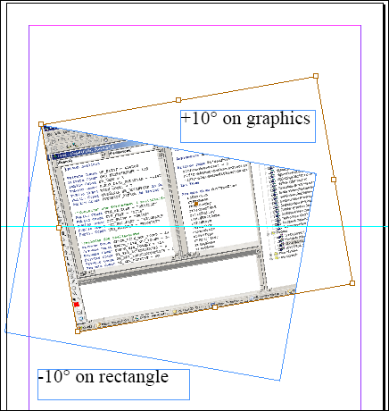

Here is a simple illustration of before (having rotated the container -10 and the contents +10 degrees:
Then running this code:

results in the rectangle being restored to 0, but the rotation "kept" for the inner graphics object (in fact adding 10 degrees to the rotation):
I've tested that, and that is the only way I can think of to do it... except for resetting the rotation and other transformation properties "manually" by calling, for example, myRectangle.graphics[0].absoluteRotationAngle = 0
