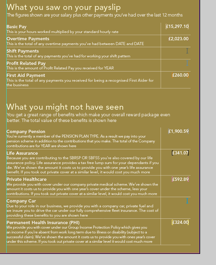

I have a similar problem as Stevie, however having tried all the scripts provided here I can't seem to resolve this.
I am using data merge within indesign to create multiple (8,000+) documents as below... However if the right hand table cell has no data (e.g. Shift Payments) I want the whole row to be deleted. Like I said, I have tried running all the scripts provided here and none have worked for me so far... any ideas? I wondered if it was to do with the data merge leaving a hidden character in the cell?
Libby

Mentor ,
Nov 18, 2015 Nov 18, 2015
I am pretty sure there is a hidden character left.
Solution could be to test contents with some RegEp, like:
var
  doc = app.activeDocument,
  _colls = doc.stories.everyItem().tables.everyItem().columns[-1].getElements(), cCol,
  _cells, cCell, k,
  checkWhiteRegEx = new RegExp ("\\S");
while (cCol = _colls.pop() ) {
  _cells = cCol.cells.everyItem().getElements();
  while (cCell = _cells.pop()) {
       if ( !checkWhiteRegEx.test(cCell.contents) )
            cCell.parentRow.remove();
Notice:
     RegEx is to test if contents match any of "not white space" character.
     If RegEx.test() fails with last cells contents ==> row is removed
Jarek
New Here ,
Hi Jarek,
Thanks for your reply, unfortunately the script didn't work, It did work on a test row that I created with text in the left hand cell and an empty right hand cell, so I think it is definitely this hidden character left over from the data merge which is causing the problem. Any other suggestions most welcome...
Libby
Mentor ,
More info about those cells contents would most welcome as well.
Can you tell any about its length? Unicode?
Jarek
New Here ,
Nov 19, 2015 Nov 19, 2015
Hi Jared,
Turning on hidden characters in Indesign reveals this (in screenshot) if I copy that in to text FIND in InDesign it appears as ^I^I^I^I (I typed this out as copying here didn't show up – don't know if that makes any difference) replacing this to nothing creates 0 replacements and the script still does not work
Hi Uwe, FIND and replace <FEFF> to nothing creates 74 replacements, the script still doesn't work. The next step using a GREP search for ^\s+ reveals nothing. Script still not working.
New Here ,
Looking in the info panel I think the unicode is: 0xFEFF 0xFEFF 0xFEFF 0xFEFF
Is this any help?
New Here ,
Another update – If I open the structure pane in Indesign I can manually untag elements from frames (I have to do this twice, once for top table then again for second table) then if I run a FIND search for <FEFF> replacing to nothing (54 replacements) the script works.
Is there any way of running a script that will do all of this? Doing this manually for each 8,000 documents produced would be a nightmare.
Thanks for you help.
Libby
