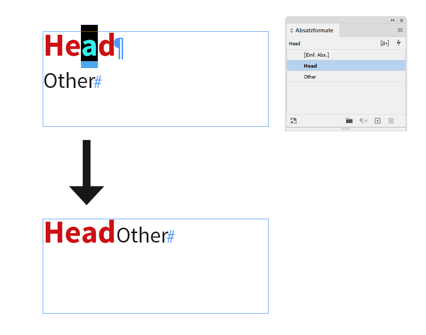

Jan 31, 2023 Jan 31, 2023
Here a visual sample:
Resulting in format overrides:
Sample InDesign document attached:
TwoParagraphsMerged-INDD-18.1.0.51.indd
