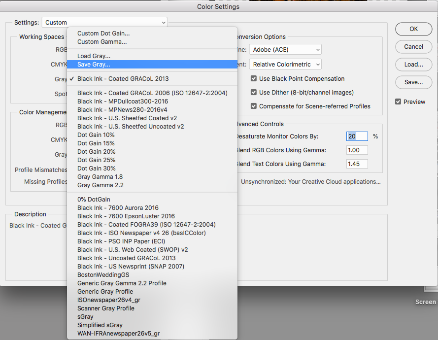

Hi Rob
Are there instructions on how to save out Black Ink profiles from any CMYK?
Are they created by Photoshop?
I figured out that you can load (and then save out) CMYK profiles into the Gray Profile.
Learn something new everday.
Thanks Rob
Copy link to clipboard
Copied
Yes you can save a Black Ink .icc profile out of Photoshop. Open Color Settings and from the Gray Working Spaces drop down menu choose Load Gray... and choose the CMYK press profile you want to make a Black Ink profile from. Here I’ve loaded GRACol Coated 2013 and it shows as Black Ink - GRACol Coated 2013:
To save the Black Ink Profile for use in PS and other apps choose Save Gray... and save to a System Profile folder.
