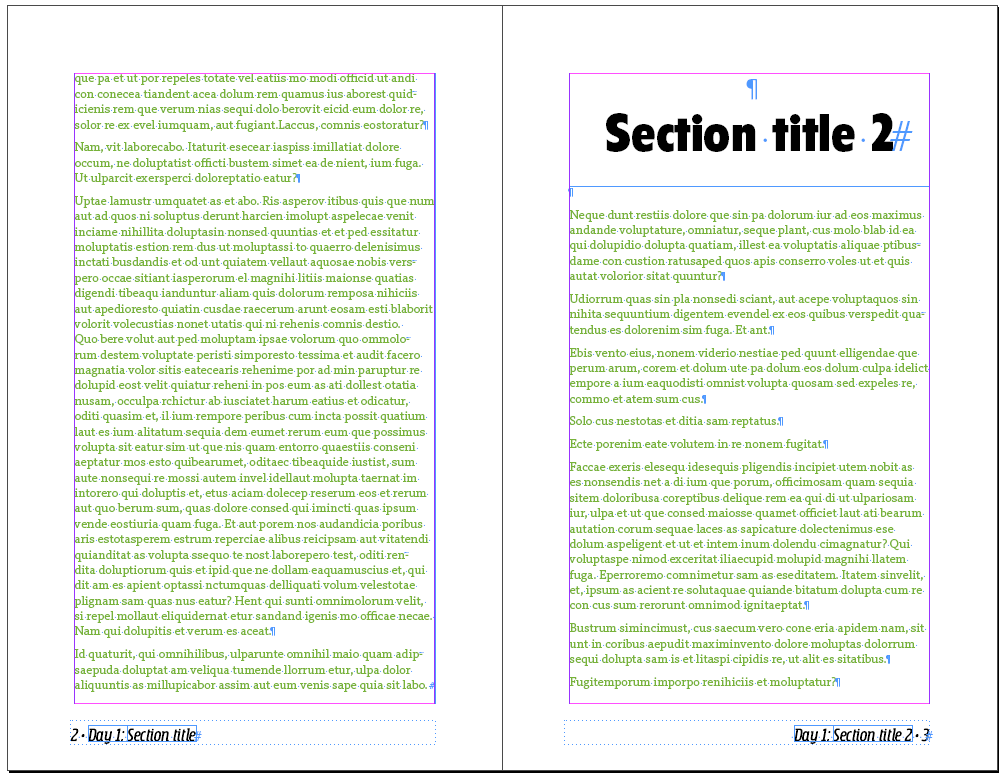

and this is is result:

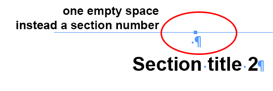

Unfortunately, as I said in my original post, adding spaces doesn't work for my setup. The styles I'm pulling are separate paragraphs, but the footer is not. The colon is part of the running header, so if I use a space, I end up with a floating colon between the page number and the section header. At the beginning of the book, if I start without a section number (in the case picture "Day"), that section is not filled in the footer, but as soon as I use a section number, I can't negate it again. I have to manually edit the footer to delete it.

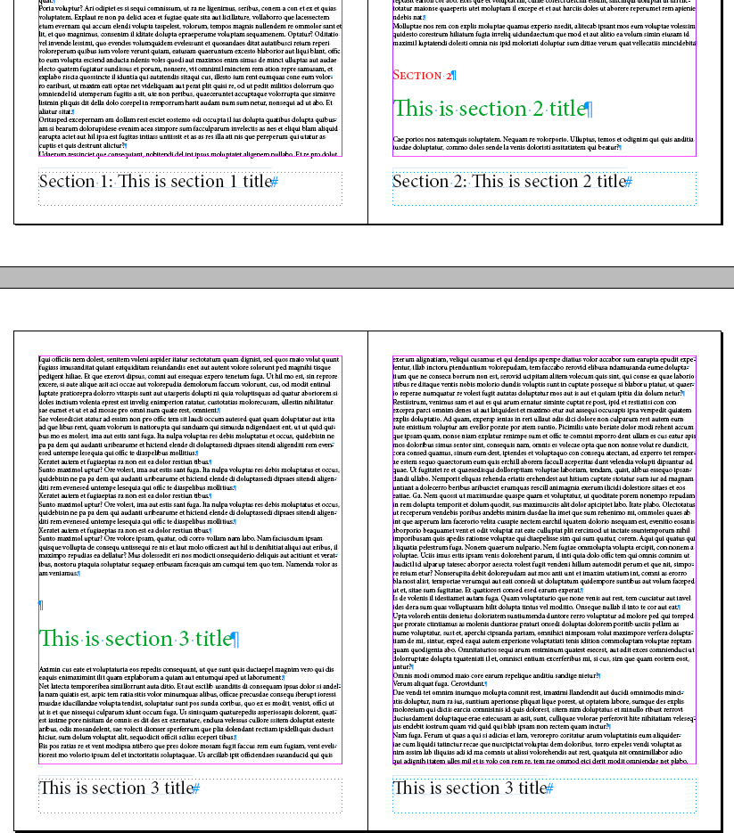

In the next example, I typed Section number+column+space+hard return and used grep style to hide it in the text, but not in the footer:

Have you properly set the variables as "last on page?"
It does work for me, as you can see on the screenshot

Ilustrated example of second method: (sorry the image didn't upload at first)
