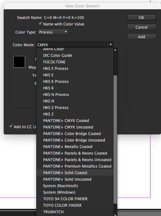

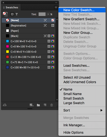

To add a spot colour to use in your InDesign document, click on the Option menu icon at the top right of the colour swatch panel.
  1. click on the Option menu icon at the top right of the colour swatch panel.
  2. Select 'New Colour Swatch'
  3. In the new swatch panel, use the Colour Mode drop-down list to select the colour book you want, Like 'Pantone Solid Coated',
  4. Type the colour number you require and click on the Add button to add the colour to your Swatch Panel
  5. Repeat the operation from step 4 as needed
  6. close the window
  7. Select your object/text to apply the colours

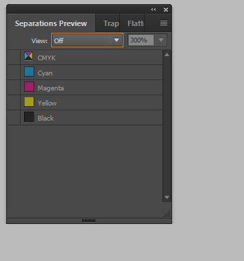

FWIW: The answer to your ACTUAL question (in my opinion) is to use the Seperations Preview:
This will list any colours in use in the document without having to do a find/replace etc...

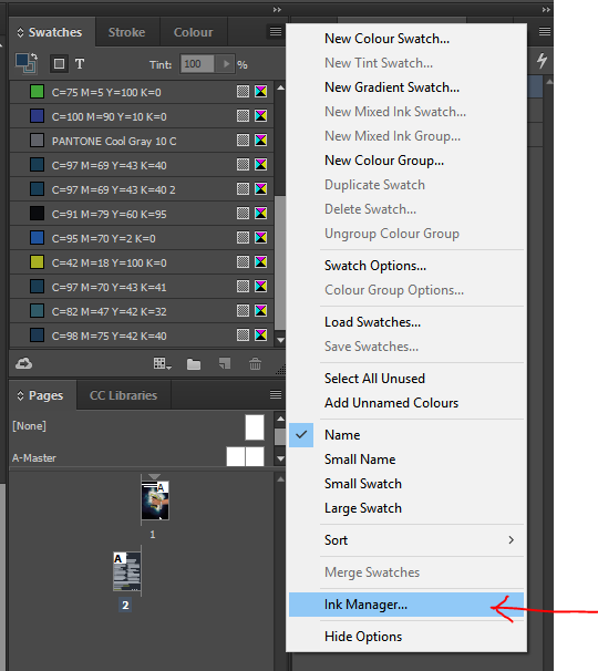

However you could also use the Ink Manager to make adjustments to any used spot colours to convert them to process:

You can use Ink Manager to convert spots to process, but if there are tints ink manager does not make the best conversion and you should change the swatch via Swatch Options.
