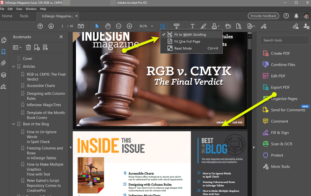

You can set the initial view of the PDF to pretty much do that, but it will likely only be honored in Acrobat or Reader.

You're need to use some imposition software for doing so long PDF. But your wish is strange. Just use it Acrobat in "scrolling view"
