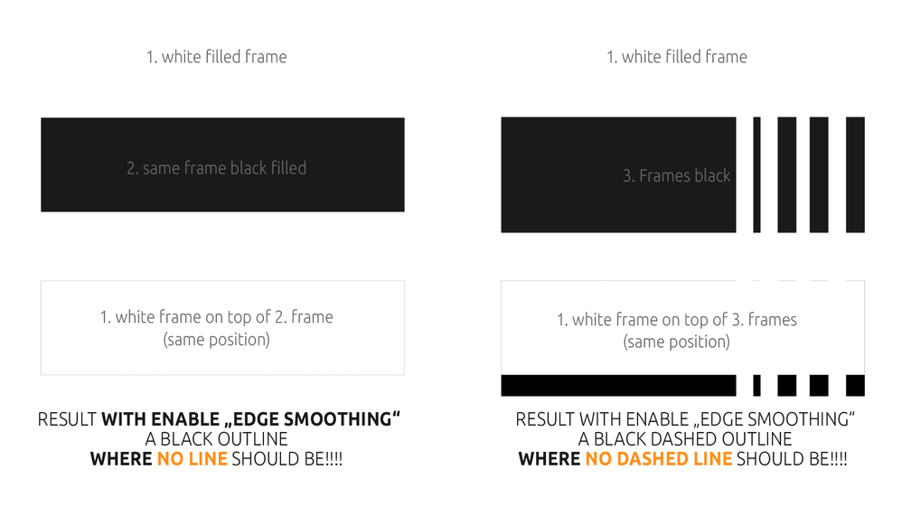

Something that is extremely annoying and obstructive when designing. This was once different and better!
No matter if e.g. black or dark frames with white "narrow - narrow" outline or areas that cover others, hairlines appear everywhere where there shouldn't be any.
I don't know with which update this has crept in. But it nevt infinitely and it was no improvement.
The only way to get rid of these lines is to disable edge smoothing completely. But then you have a pixelated view with the charm of the 80s. So this is not an alternative either!Bildschirmfoto 2021-07-16 um 19.40.31.png
Bildschirmfoto 2021-07-16 um 19.45.47.pngBildschirmfoto 2021-07-16 um 19.40.07.pngGPU Unchecked.png

Do you want a stroke? If so make a difference in size between the objects.
The hairline you are seeing is a result of antialiasing, and is an on screen artifact created by the constrains of mathematics. If you are trying to get a custom dashed line you can do as you are doing but make the box below slightly larger. The effect of having the lines dissapear will vary with zoom level, and is only affecting the representation on screen.
(you will get similar artifacts if you have a selection in photoshop, fill with black and then fill with white)
What is happening is that the computer is faking more resolution that you have by making partially darkened pixels on the screen grey rather than black or white. When you add the white box, pixels that are partially white will be lightened by the % covered by white to simulate since screen pixels cannot be split. Because if you darken by 50% and then lighten by 50% you don't end up at zero, you will get tis happen at certain zoom levels, and certain positions.

Hi Lukas,
Yes, I know that these lines vary depending on the zoom level. Which unfortunately does not make it better. But the setting of my monitor is on original resolution and not scaled.
The artifacts that happen today in Indesign are new to me at least. Because I know that these lines did not exist before (at least not for me).
The lines appear e.g. also if one uses another, than the continuous line with borders, (thus e.g.: "Wide - wide" s. Screenshot) and the background is darker than the line.
However, it disturbs the design and I always have to explain it to my customers.
I know the lines in the kind of course already for years from Akrobat and know therefore around the trigger "the edge smoothing" and that they are not mher there in the pressure then. Nevertheless, the display is incredibly annoying.
If I knew with which update they came, I would posthaste install the old version of Indesign again. The updates have been buggy lately anyway.
However, I would find it even better if the old display state could be restored, as it was, namely good.

The problem is the rules of mathematics, understanding what creates the phenomenum lets us work around it. It is not a bug it is a limitation of how things are designed. As for the stroke when you have a Gap colur the colour is calculated to be a full width stroke under the stroke (why the artifact appears). Knowing this the sroke can be designed in the reverse as shown here (you will need to switch the gap and the fill colours)
Here the stroke is made of the Gap with the stroke being over. Since there is no double strokes you do not get this effect. When it comes to your photos it could be how you are masking that is creating your problem. Clipping the object so that you do not have the edge of a mask will ensure that you do not have missmatch in edge pixels.

Hi @Tom Reuter ,
Thanks for the IDML share.
OK, here's what I found.
I don't think there's anything wrong with your settings or prefs.
It seems to be be the way ID is processing the information.
Two ways to get around this imho.
  1. Tweak the way you work slightly to accommodate for the artifacting.
  2. Image it to a print device and see if the problem persists. It is visible under high magnification, so it might be like a PDF/X1a aritifact, which e might be able to ignore.
Page 1, the double line on the circle creates the the artifact. If we choose another line type it does not show.
Page 2: If we reduce the black block behind by a factor of 0,3%, the artifiact goes away. Or if we introduce a stroke of 0,1mm on the top object, it also goes away.
Page 3: Same
Page 4: Same
Page 5: Making the Black object shorter so it touches the Pantone Stroke works for that.
Page 6: Placing a stroke or making the the white box slightly deeper sorts that.
No amount of preferences and GPU settings changes are going to make this go away @Tom Reuter . I don't think.
Tweak your workflow while you wait for Adobe to give you answers
Hope this helps
mj

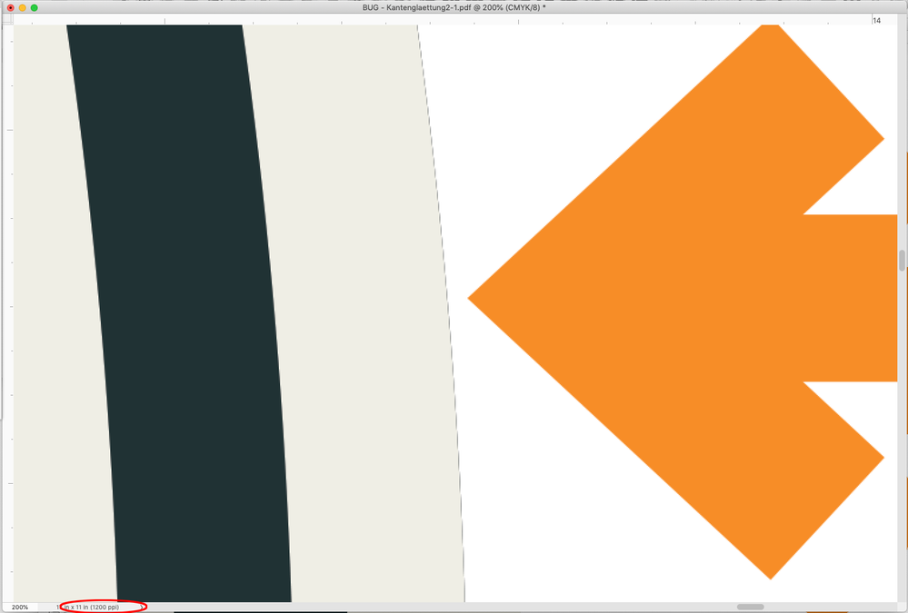

Hi @mj, it’s possible to imitate RIP output by exporting a PDF and opening it into Photoshop at the output device resolution with Anti-Aliasing turned off.
So here is page 1 of @Tom Reuter’s ID file exported to PDF/X-1a and opened into Photoshop at 1200ppi, with Anti-Aliasing on and off:
AA Off:
AA On (a RIP would not anti-alias)
