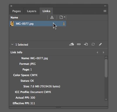

Then you drop your Images into InDesign as links.
You see at the bottom of the image it shows EFFECTIVE and ACTUAL
So at 100% it's size it's actually 300ppi
But it's scaled (reduced) which brings up the Effective PPI to 311 PPI
So the image is scaled to 96.46% (300/311*100)
In short
Your document should be at the output size and final size of your Print Dimensions in inches or mm etc.
You don't need pixel based dimensions for your pages
When you use File>Place and insert the image you can see directly in the Effective PPI what the image size is in PPI.
Then on export to PDF you can reduce all images to the PPI you desire for printing.
Or I'm probably missing something here.

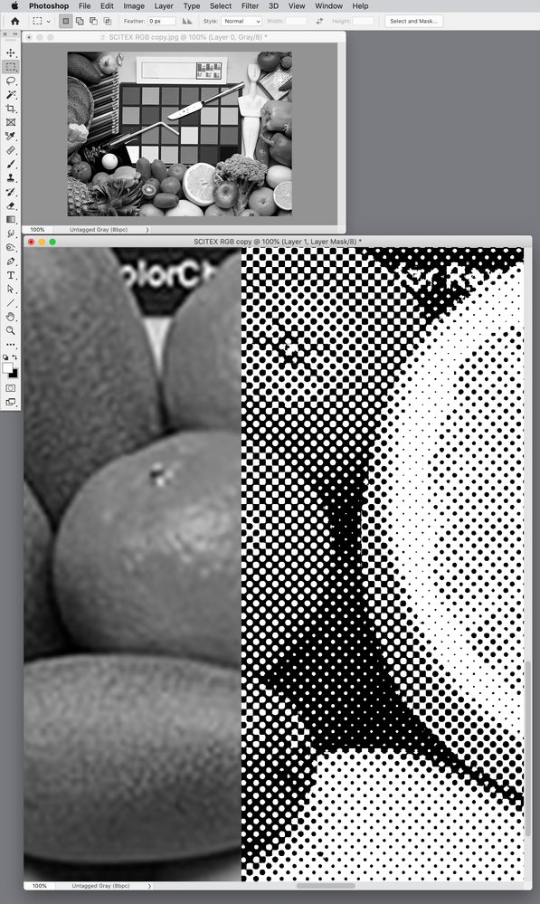

This thread is a good example of why Adobe explicitly defined their terminologies for different kinds of resolution back in the early 90s—PPI, LPI, and DPI.
Image resolution is referred to as PPI, not DPI, and that usage is consistent in all of the Adobe print apps. For all commercial printing methods, pixels are not output—image pixels have to be converted by the print driver to a screen (LPI), and that screen is drawn with printer dots (DPI). Changing an image’s pixel resolution will have little affect on the output halftone dot sizes. It’s the screen (on the right in this simulation) that is output, not the pixels:
