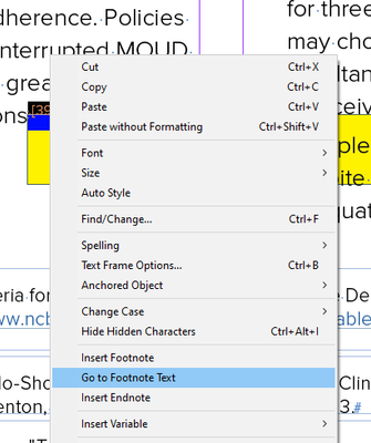

But you don't have any Endnotes there?
I'm not sure why do you have to create Hyperlink - even with Footnotes?
If I do this on the Foottnoe marker:
it goes straight to the Footnote's text?

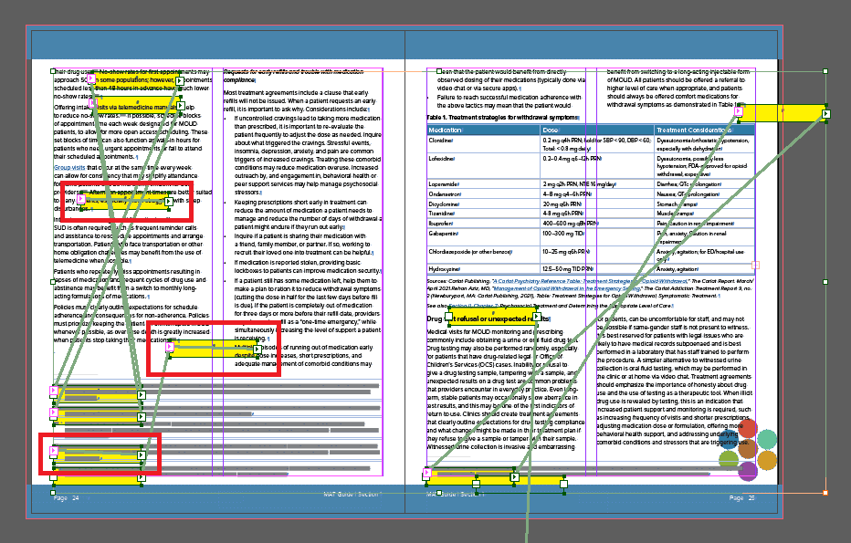

Feb 18, 2025 Feb 18, 2025
@Debbie5C13
Link sent.
The improvements:
  • before, there was only one layer - now, each type/kind of Hyperlink has it's own layer:
so you can change order and show/hide layer's you don't want to see / investigate.
  • before, there was only one ObjectStyle - now, there is a separate one for each type/kind of Hyperlink - named exactly the same as Layers:
so you can change how those TextFrames will look like - and control their width as well.
If I were you - I would start from checking things that won't affect the flow - or from the end of the document - one layer at a time.
If you play with TextSource and TextDestination ObjectStyles - set Transparency to Difference - it might help you to spot "the bad ones".
Here is an examaple of only one layer visible - TextSources:
with three "bad" ones - they have a line across them - line displayed by InDesign between threaded TFs - and an "in port" on the left with a different color than the "out port" on the right:
If you'll work on the TextDestination layer - you'll have opposite situation - those small triangles will point the other way.
