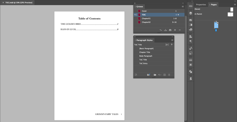

The screenshot below is what I did.
Could you comment on it, if you don't mind?
Hosun

Oh, I see, you're using a Book.
It looks as if there is no primary flow text ahead of the TOC, depending on how the Cover section is structured. You could put the TOC in that first chapter and anchor it to the last paragraph.
Or you might try putting a text frame in the TOC chapter, with one Body Text paragraph in it, and anchoring the TOC frame to it. I can't recall offhand having done a TOC  this way (completely in a Book chapter of its own), but it's where I'd start.
I am not sure I'd use a Book structure for something this short. Keeping chapters in individual INDD files is usually to permit collaboration (with the chapters from different author/sources) or to break up a very large publication. Going to a single file would bypass many steps, complications and potential problems.
