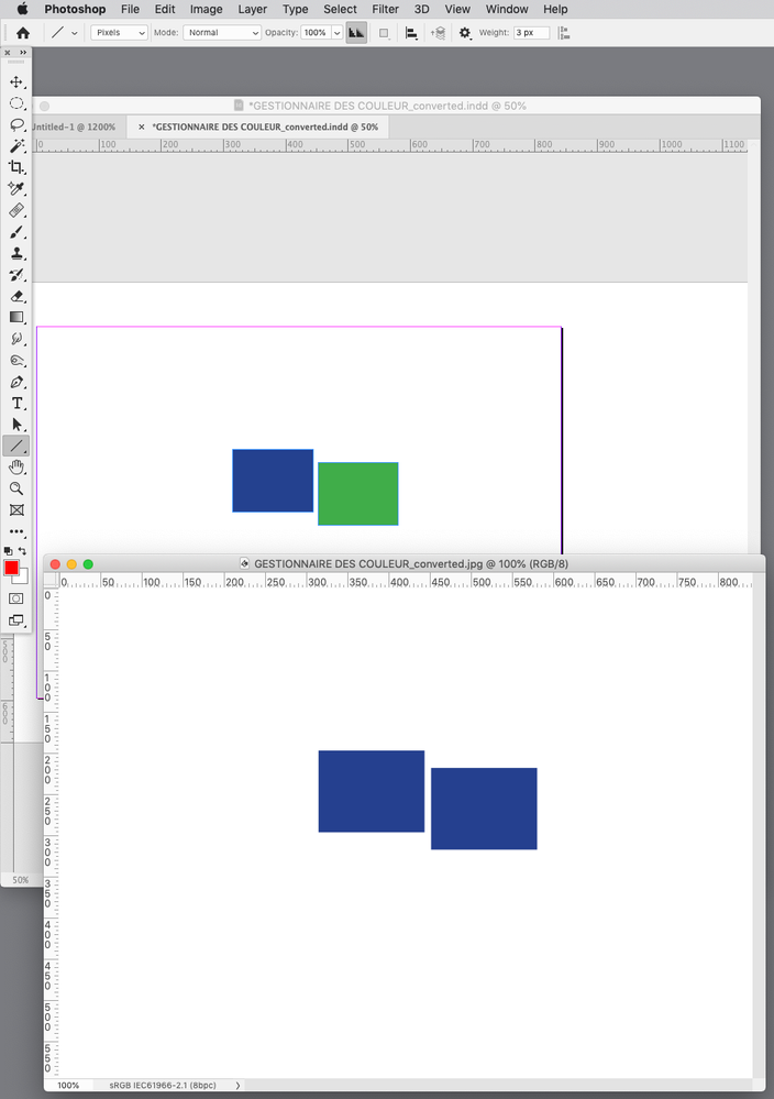

Feb 25, 2021 Feb 25, 2021
@guillaumes83311920 is aliasing the Nouvelle couleur 2 swatch to Nouvelle couleur via Ink Manager, so the print output should be this where I have Overprint turned on:
The InDesign JPEG export ignores the alias and exports this:
PDF will honor the alias

Mar 03, 2021 Mar 03, 2021
Try this Javascript JPEG Export:
https://shared-assets.adobe.com/link/892b27ac-92f1-4c7b-7368-cb97688fd997
I tested your file and the aliased inks exported correctly.
