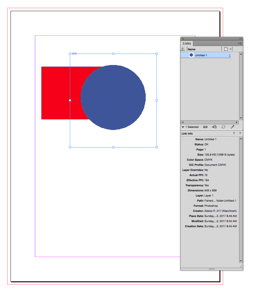

Maybe to clarify–vector objects in an exported EPS wouldn't have an opaque bounding box, but bitmaps with transparency placed on the page would lose their transparency and get a opaque bounding box. Like below where the blue circle is a PSD bitmap with a transparent background, and the red square is a native InDesign rectangle (vector):

Exported as EPS and placed back into ID on a gray background:
The same page exported as PDF/X-4 and placed back into ID
