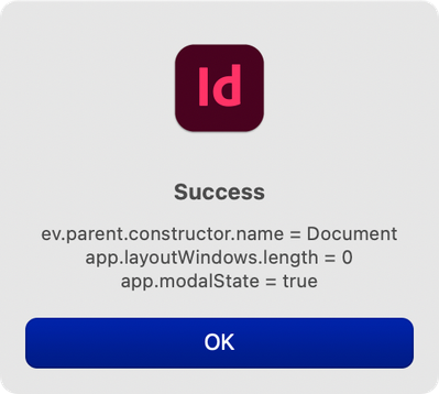

Hi all, I'm trying to run some ExtendScript code when the user creates a new document but I'm not getting it to work. I've probably made a basic mistake, which someone can point out, but otherwise, could anyone test my script on their system?
I expect it to name the first Layer "TEST" but for me it throws an error (which the script handles and displays in an alert).
I'm using Indesign 19.0.1 and MacOS 14.1.2.
Here is my test case, whch I run from the Startup Scripts folder:

This is what I see every time I create a new document:
Thanks in advance.
- Mark
Edit 2023-12-05: added an alert even if the test was successful, added screenshot.

Enthusiast , Dec 06, 2023 Dec 06, 2023
Tried with InDesign 19.0.1 and macOS 12.6.7.
It always succeeds when in the legacy new document  dialog. New format new document dialog causes errors. Even when it succeeds, the modalState is true, and it seems to be executed before it finishes creating the document.

I think Marc’s code (the first one) doesn’t work as intended. modalState is true in both cases: with the default and legacy New Document dialog box. So, in my opinion, it makes no sense to check if it’s true/false. The problem occurs with the default dialog when the user clicks the ‘Create’ button or turns on the ‘Preview’ checkbox: the error — Cannot handle the request because a modal dialog or alert is active. — is generated. It happens while the script attempts to rename the layer.
I suggest the following modifications: check if the specific error occurs and give a warning offering the user to turn the legacy dialog on.
