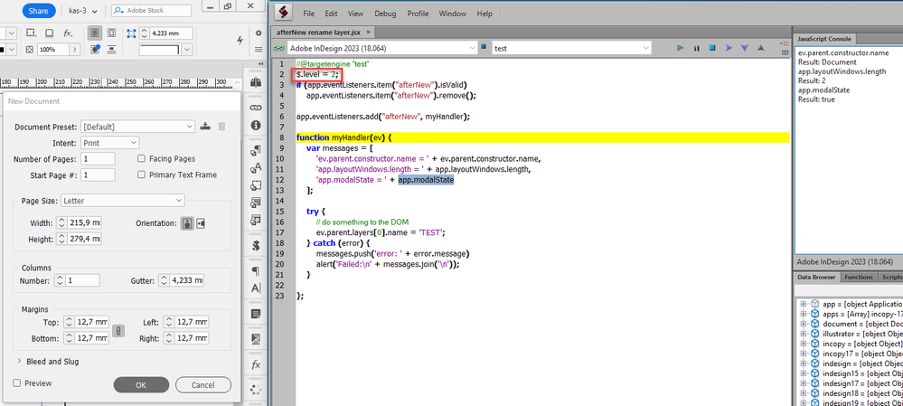

Another idea: set the script to the Full debug mode.
Not sure if this works on Mac in VSCode, but on Windows, on clicking the OK button it is opened in ESTK so you can debug it step by step.
— Kas

Valorous Hero ,
Dec 05, 2023 Dec 05, 2023
No, modalState is true.
The event occurs while the new document window is open.
— Kas

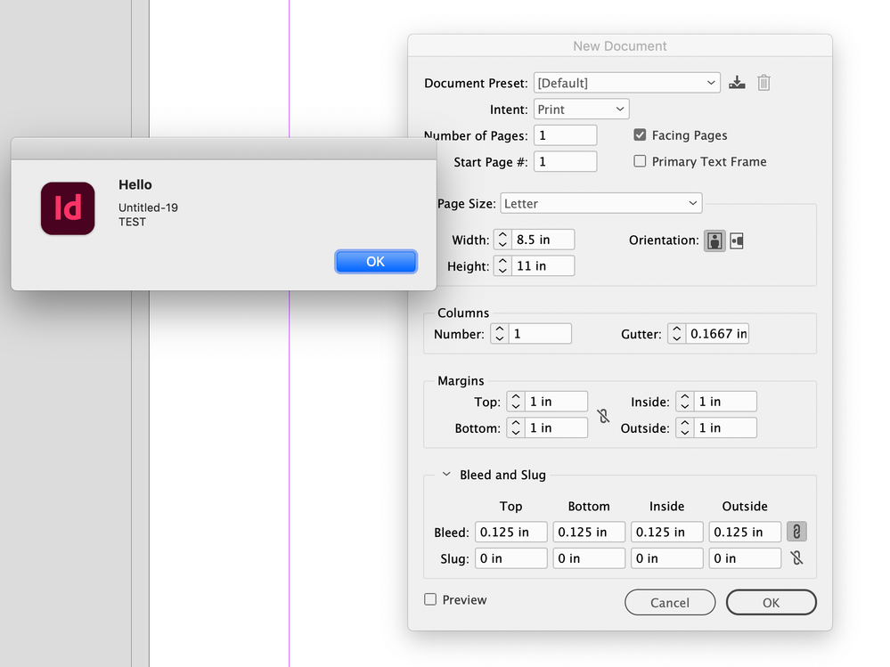

Hi Mark, I haven‘t had a chance to test your code, but this works for me with CC2021 on Mojave directly from VSC:
#targetengine "namelayer"
var an = app.eventListeners.add("afterNew", setLayer);
function setLayer(e){
    var d = e.parent;
    e.parent.layers[0].name = 'TEST';
    an.remove()
    alert("Hello\r" + d.name + "\r" + d.layers[0].name)
Others have suggested that you don’t need a #targetengine line, but I always include one when using event listeners—not sure if that might be your problem?

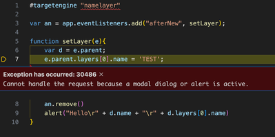

Thanks for the test @rob day. Here's what I get, from VSCode:
Oh well. I'm hoping someone will be able to test using Indesign 19.0.1 and MacOS 14.1.2.
I still don't know if it's a new bug/incompatibility or something particular to my setup. Thanks for helping.
- Mark
