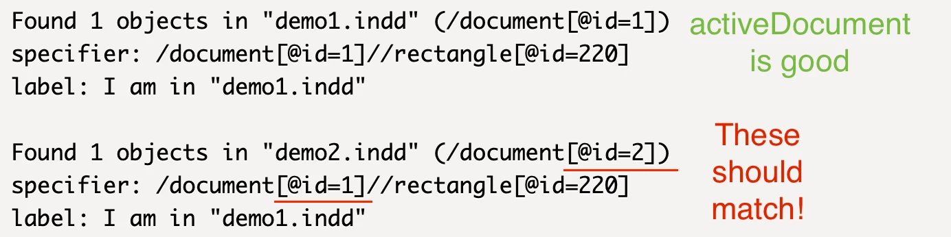

Here is what I see when I have demo1.indd active:

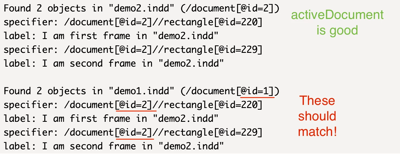

Here is what I see when I have demo2.indd active:
The problem seems to be that doc.findObject() is performed on the activeDocument, not `doc`. You can see that the specifier for the found object always points to the active document, not `doc`.
Of course the result I expect is to iterate over all three frames—one from demo1 and two from demo2.
Am I missing anything here? Can anyone reproduce this? I couldn't find a bug report on uservoice, so if no-one corrects me here I'll lodge one.
