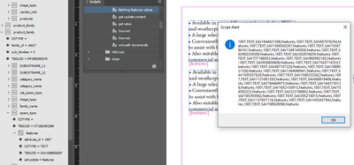

Explorer ,
Oct 12, 2020 Oct 12, 2020
For another time I have used this script to fetch the xml attribute value by that time I get an null value. Hereby I have attached the screenshot.
Nithu
Advocate ,
By seeing your screen shot.
What you have selected is the node with name "feature".
But what code does is it will find all nodes which are having attributes named as "feature".
And it will give you result in return in an array.

Explorer ,
I have used the given script but it doesn't get the attribute values. But it provide attribute_id and paragraph style used for the attributes present in the xml file. I have attached the screenshots which I get after using this script
Nithu
Advocate ,
Hi Nithu,
As per your XML structure in InDesign File, it looks like attribute_id, COTYPE, TBGUID & aid:pstyle these are the attributes of that node named "features" & in that alert I can see you are getting values of all those attributes.
But it seems you want to do something else. Please elaborate what do you exactly need. Then only I can guide.
