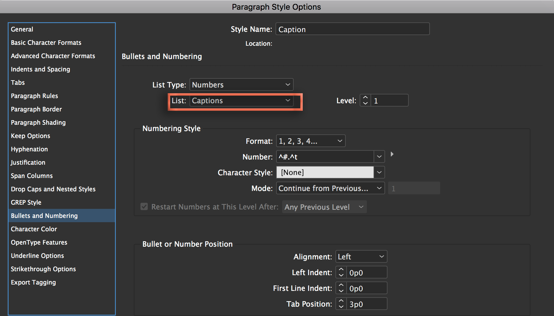

Why would that result in all figure numbers being the same?

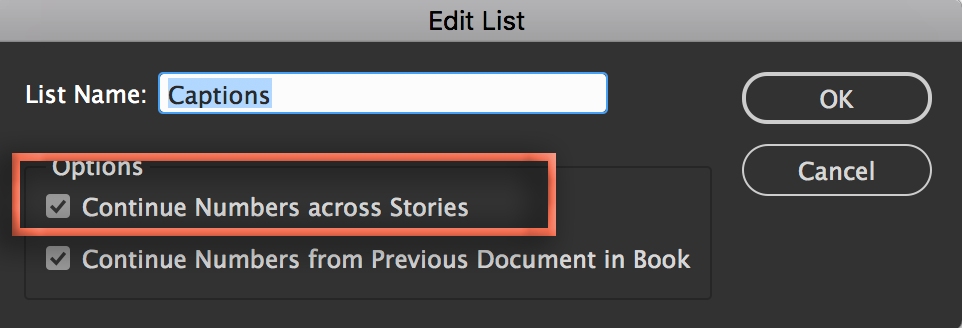

Because each caption is appearing in its own unthreaded frame. As per Steve's link at the top, you need a named list, and you need to tell the list to continue across stories.

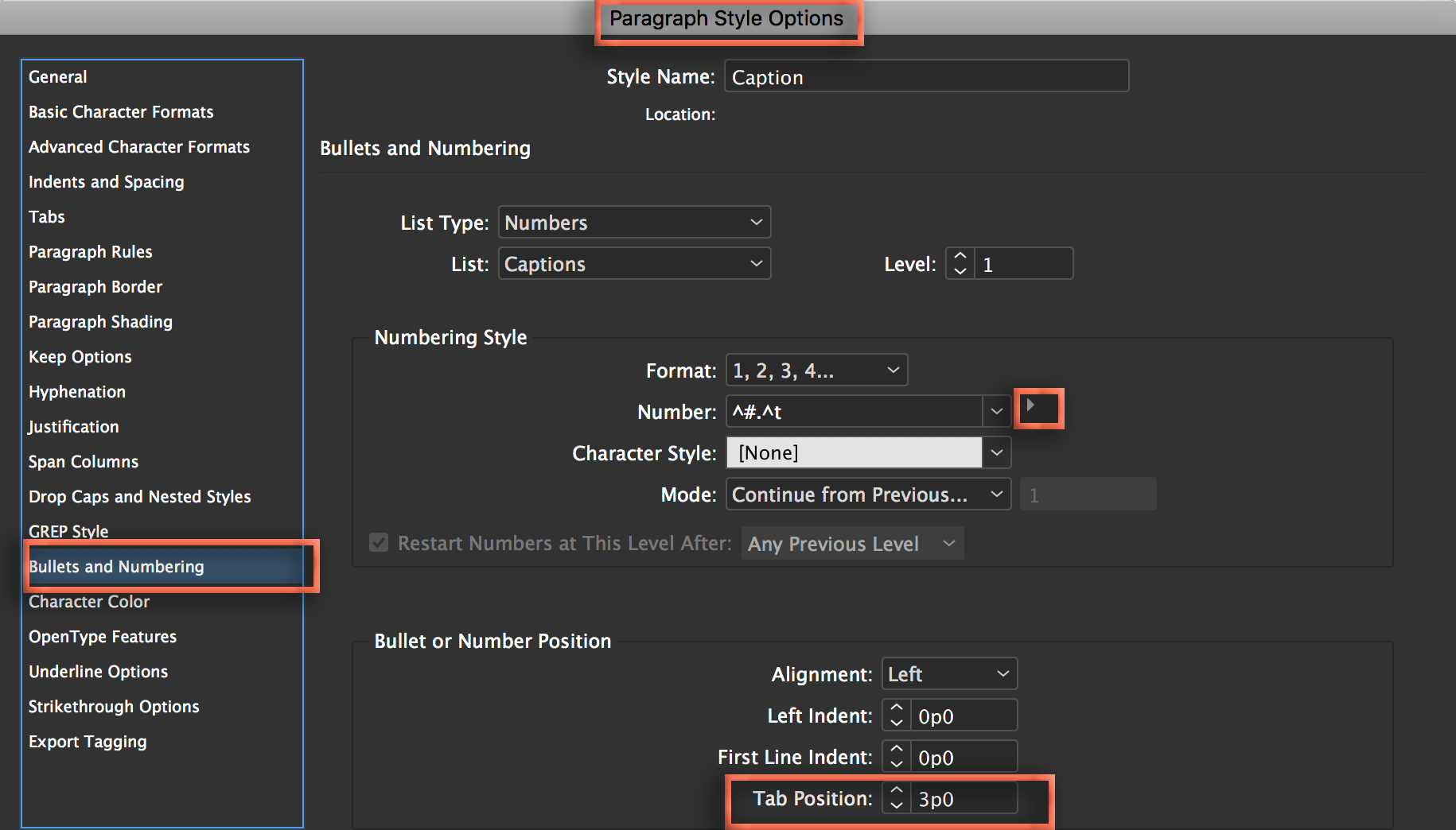

If the space between Figure 1 and the caption text is not to your liking you have two options:
  1. Adjust the tab position—you may need to increase it. It doesn't matter if you measure in inches, points, picas or mm, just use the arrows in front of the current value until you get the desired result.

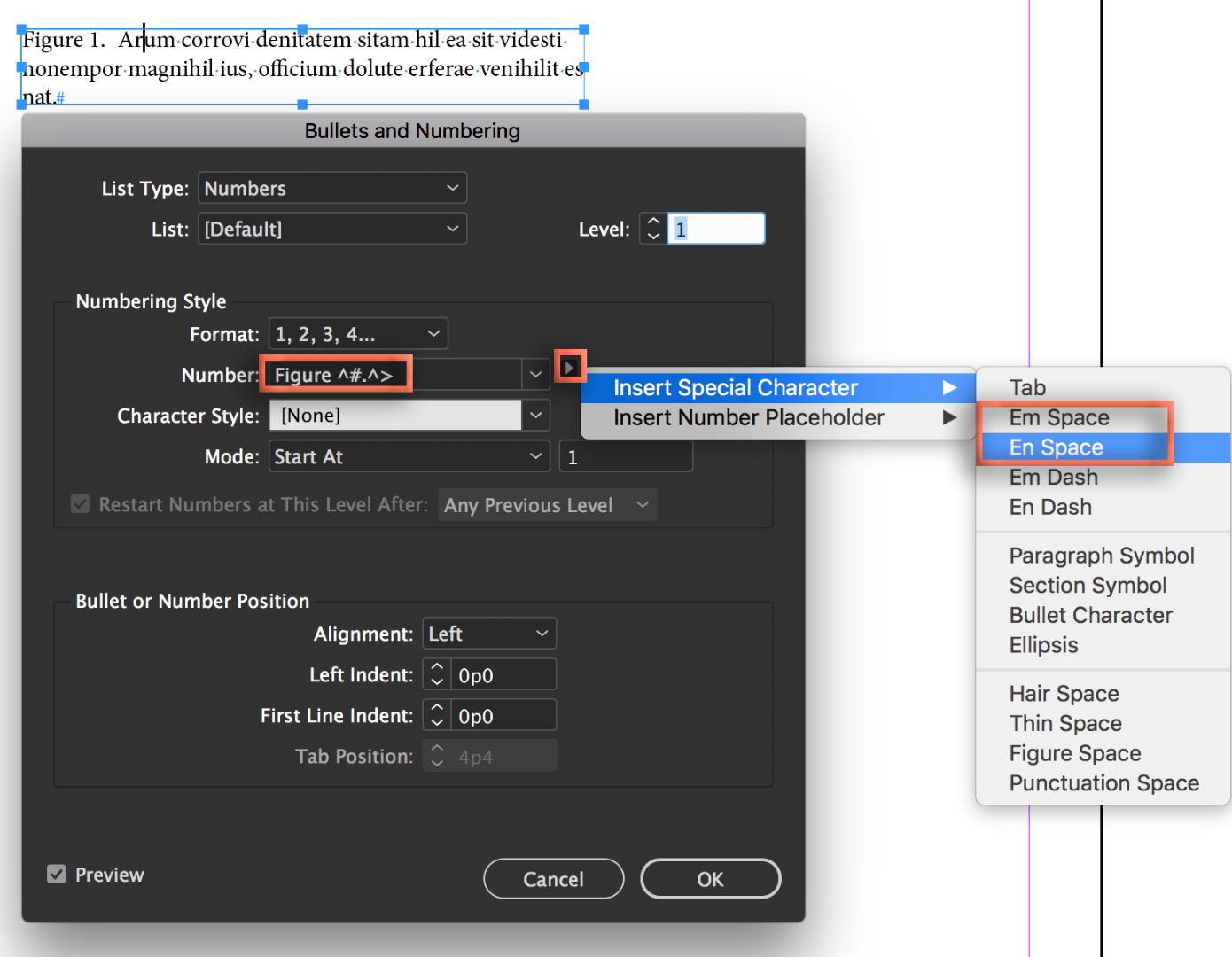

  2. Alternatively, do away with the tab character altogether, and put in a fixed width character. Try both the en and the em space to see if either of those will work.

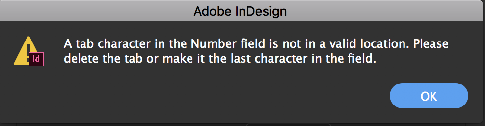

If I type m manually after .t, that gives me the following message: ‘A tab character in the Number field is not in a valid location. Please delete the tab or make it the last character in the field.’ That is confusing because it is the last character in the field.

So then I tried to follow your ‘Option 3’, i.e., to insert an em space after the #.t, but inDesign does not like that.
I offered two options—adjust the tab position or remove the tab (^t) and replace it with an en or em space. If you try to keep the tab and add the en or em space you will get this message:

As per the earlier screen shot, remove the tab. Try an en or em space.
