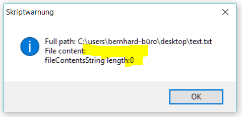

I'm searching a way to read (and subsequently edit) the contents of a text file on my disk. I thought it works with the File.read() function but when I run the following I get nothing from the file. How does it work? How do I get the string with the file content? I tried different functions like readln() etc but with no luck
var testtextfile = File("/c/users/bernhard-büro/desktop/text.txt");
testtextfile.open("r", undefined, undefined);
//also tried with .open("r"); and .open('r');
var fileContentsString = testtextfile.read();
alert("Full path: "+testtextfile.fsName+"\r\n"+
      "File content:"+fileContentsString+"\r\n"+
      "fileContentsString length:"+fileContentsString.length);
testtextfile.close();
this is the result: (and what is the proper way to format code in this forum?)
Thank you very much!

Guru , Aug 23, 2017 Aug 23, 2017
Often the cause is encoding related.
Try
testtextfile.encoding = 'UTF8'; // set to 'UTF8' or 'UTF-8'
testtextfile.open("r");
alert("Full path: " + testtextfile.fsName + "\r\n" +
    "File content:" + fileContentsString + "\r\n" +
    "fileContentsString length:" + fileContentsString.length);

Community Beginner ,
Aug 28, 2017 Aug 28, 2017
Hi Trevor, thanks a lot for that. I still have to find out what exactly is going on in detail about the character encoding on my system (changing it doesn't seem to be necessary in most cases) but now I can parse the text out of my file, great! Kind regards, Stefan
