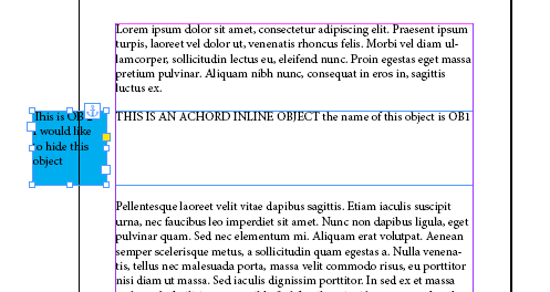

What is the easiest way to find an anchored object within the document. I this case I would like to find OB2 (the cyan square ) and hide it.
If you know an easy way of doing this I would be grateful for your help. I am using jsx.

Thank you for this but it only works if the layer is on the very top of the hierarchy.
So in this case
app.activeDocument.layers.itemByName("OB2").visible=false
Will fail. Because for me app.activeDocument.layers.itemByName("OB2") returns an inValid layer.
This would work
app.activeDocument.layers.itemByName("Layer 1").visible=false
Because Layer 1 is on the very top.
So is there any way to find the OB1 or OB2. Or maybe I am doing something wrong  ?   : )
