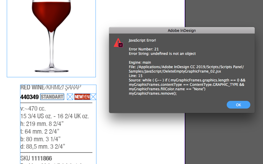

Hello, thanks for script. I am trying this script, but it doesn't work. I am getting this error;Screen Shot 2019-11-27 at 00.04.58.png
Thank you for your help.

Same here. I get the "undefined is not an object" error as well.

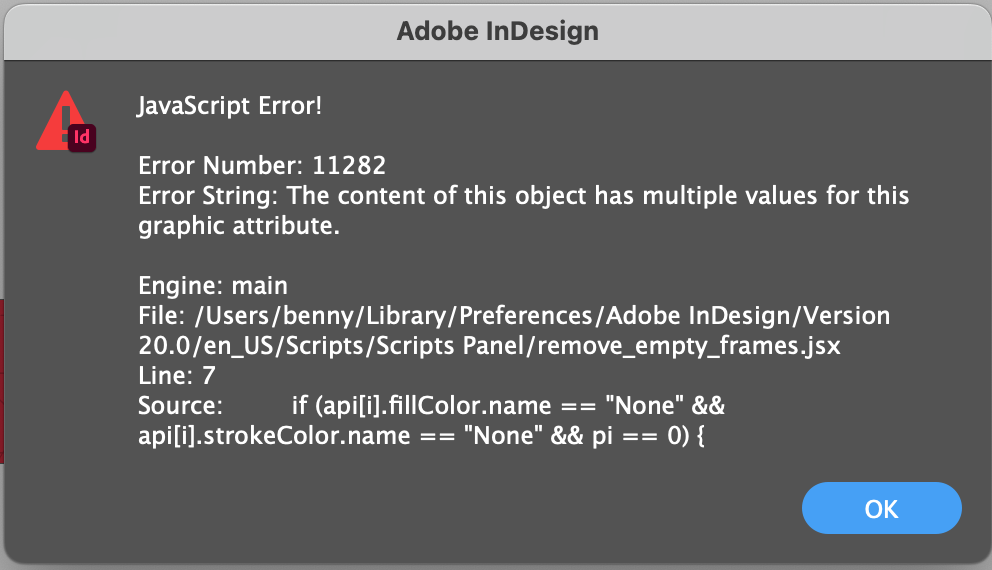

Still not working here. I get this error:
