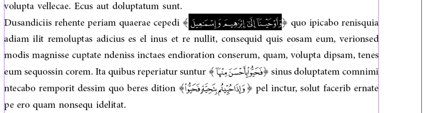

I am trying to make a script to find any text between two glyphes ( ï´¾ ï´¿ ) and create a new character style for the selected text .
note : i do not want to apply a character style on the selected text , but i want to create a new character style for the selected text .
note : i do "find what "correctly but i do not know how to complete the script .
i am start but i do not know how to complete  :

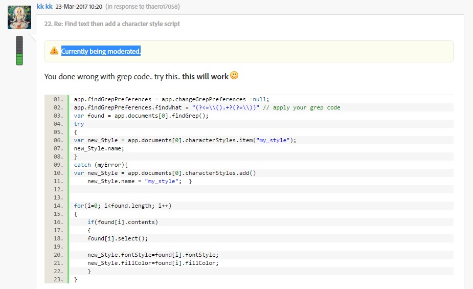

You done wrong with grep code.. try this.. this will work
app.findGrepPreferences = app.changeGrepPreferences =null;
app.findGrepPreferences.findWhat = "(?<=\\().+?(?=\\))" // apply your grep code
var found = app.documents[0].findGrep();
try
var new_Style = app.documents[0].characterStyles.item("my_style");
new_Style.name;
catch (myError){
var new_Style = app.documents[0].characterStyles.add()
    new_Style.name = "my_style";  }
for(i=0; i<found.length; i++)
    if(found.contents)
    found.select();
    new_Style.fontStyle=found.fontStyle;
    new_Style.fillColor=found.fillColor;
Guide ,

any one in the forum leaders let me know why always the reply getting moderated?

If you want this is a sample text ... you can try the script on it .... this is maybe help to fine the problem :
In precabo. Occaborem reptate pe plabor ﴿ ﭞﭟﭠ﴾ assitat ut eaquid magnis ea inciunt labo. Ut verciis doloriatquis restiatusa consequi desequam dolut voluptat fugia voluptatus abo. Rovid magnis dolorro excerna tecatatur, conseque ﴿ ﮦﮧﮨﮩ﴾ explignistia nem vel est, vitate di optatestium que pel eumquas volessim adicipit volorro vidictur sin num nonet eum eturehe nihillenim quiatiatium consequo blaccum nam ea vitatium ut alia nes veliquatur, sitio modisqu iatem. Et endit maio blab iur ﴿ ﭑﭒﭓ﴾ andaeri squundus que cuptas quiatqui id ea doluptius suntotatus il incia commolo eos doluptatusam venis nulparibusci omni omni dis arcipsaest atquam quisqua tiumquis enduciis nonecte porerore num dolupiciae niet alit omnisque natium qui reperciat audistis mintem aut endanis tibus.

I try the GREP code in find/change in InDesign and it is good and select what i need to select .
i think the problem in the script , but i do not know it .
