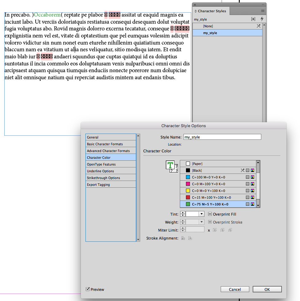

If you feel again it is not working, then just record your work as video and send to me.. or post here..
In my end it is perfectly working for all languages..
