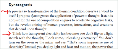

I have this 300-page text to lay out, and soft returns are used extensively in the text as a second type of paragraph break. I would like to know if there is a way to automate a first line indent after every soft return. Is there?
I know now that Indesign doesn't consider a soft return a paragraph break, and I haven't been able to find a workaround that doesn't involve either (a) indenting manually, or (b) separating the paragraphs manually. As far as I understand the proper way to do it would have been to have only hard returns in the source text, and then to use two different paragraph styles in Indesign.
Any suggestions on how to best solve this, given the situation?
