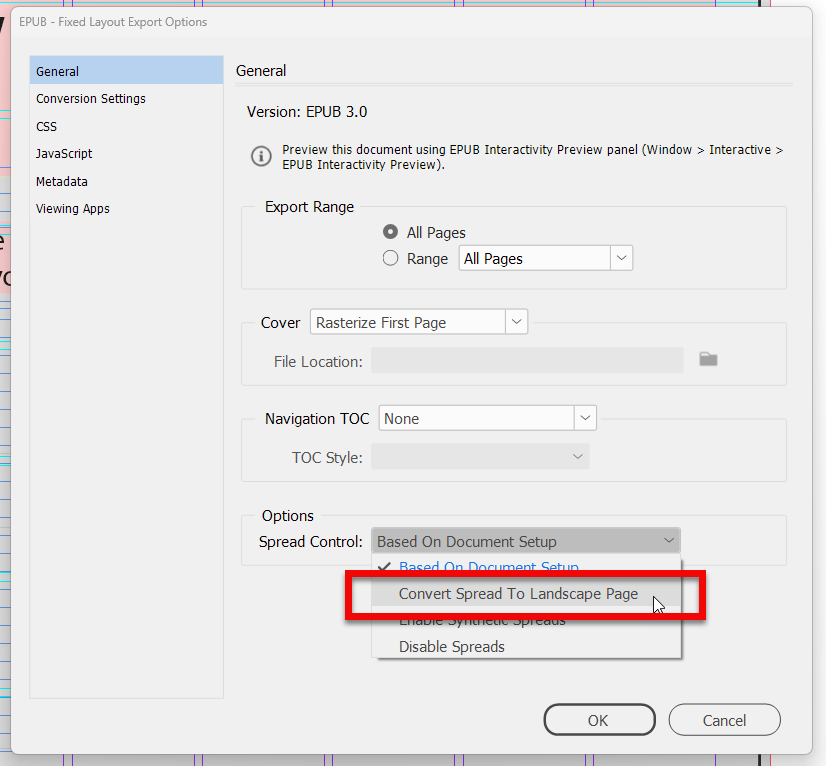

fixed layout epub exported from indesign with image over two pages (spread) appears with scroll bar in the epub. Should only show image accross the two pages without center having scroll bar. How to fix. Thanks

Community Expert , Apr 04, 2024 Apr 04, 2024
When you export, choose to combine the two pages as spreads.

What reader are you looking at this with? Is that a two-page spread converted to a single page on export?

Thank you for commenting. The reader is ibooks. It shows both pages at a time. if the images do not overlap the center of the two pages there is not a problem. But if I have an image that crosses both pages it shows a scroll bar.  I also opened it in Calibre, but it only displays one page at a time. When I look to export to epub I do not see any choices to change anything, it just exports. If I export to a pdf, there is no problem.
I am using a Mac with a 32 inch screen. If I make the epub display about the size of an iphone or view it on the iphone it is perfect. Any ideas?

Perfect!  Solved. Thank you.
