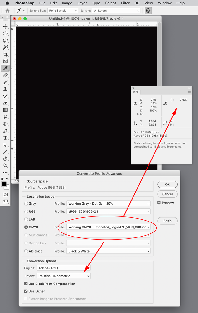

The printer will be using offset printing and the profile used for the uncoated paper is Fogra47 with a total ink value of 280%.
If your printer is serious about the 280% ink limit—the total ink amount where there is a danger of the ink not drying and causing offset—then you might use the 260% version to be safe.
On thing to note about total ink—the Conversion Options Intent you use for the conversion can affect total ink. So with the 300% version you would get 300% on an Absolute Colorimetric conversion, while Relative Colorimetric converts the black point to 275%—normally there is no reason to use Absolute.
Also, if you make the conversions check with the printer that they will output your values unchanged. Some printers want to make their own conversions—usually to make sure the total ink is not over their number. If that’s the case you would be better off providing profiled RGB images (PDF/X-4 with no conversions), so you don’t end up with CMYK-to-CMYK conversions at output.

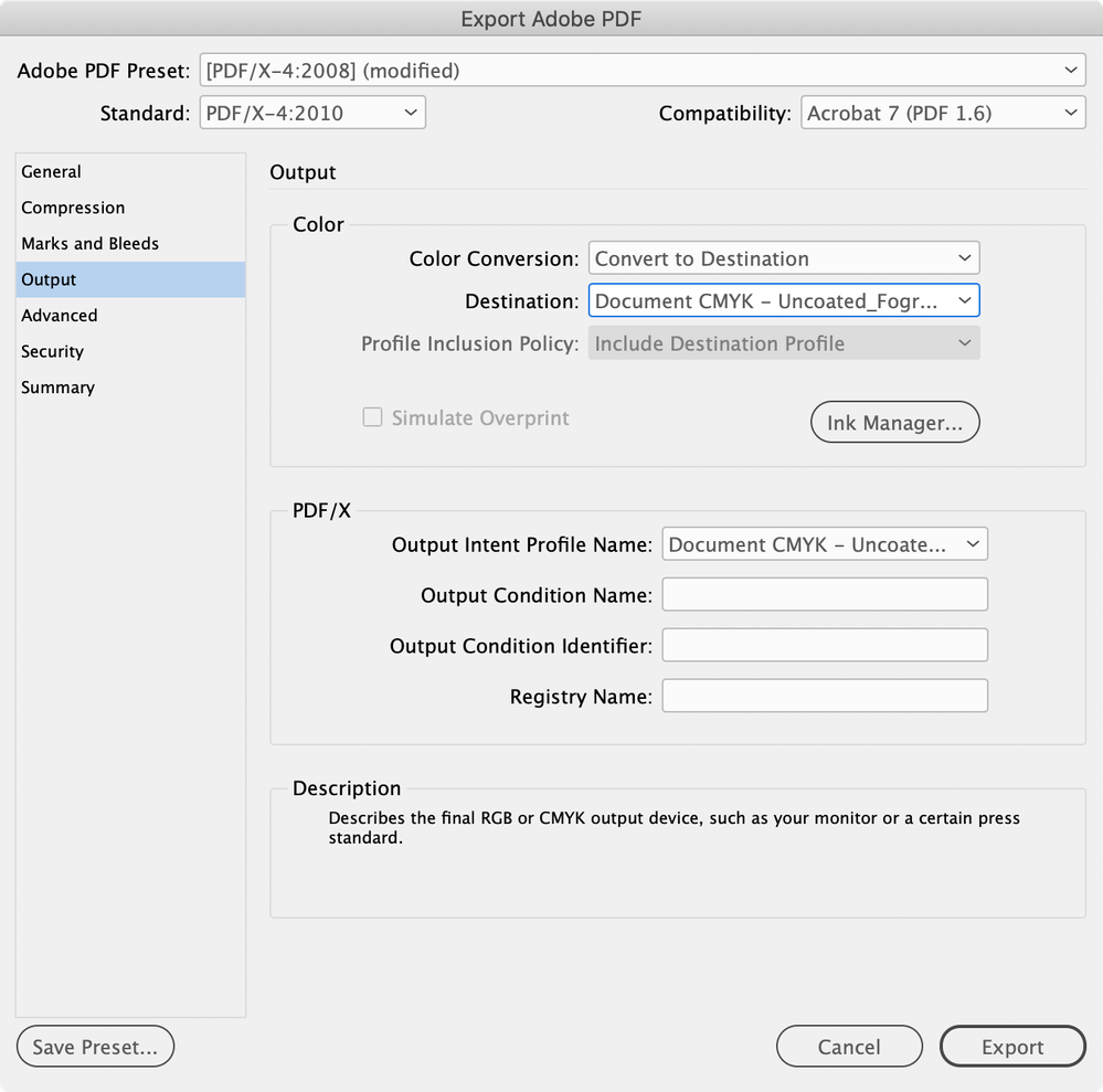

But you don’t have to make the CMYK conversions in Photoshop. It‘s more efficient to place RGB images with their profiles embedded and make the CMYK conversion from the PDF Export Output tab. Something like this would convert all of the RGB images in your document to the assigned CMYK document profile:

Hi @rob day , thanks again for the detailed information! I have changed the settings which got rid off the blue cast throughout inDesign. Unfortunately this did not solve when the PDF is being exported whether I do the conversion through Photoshop or all together through Export Adobe PDF.
Somehow the blue cast doesn't seem to dissapear on the final.
