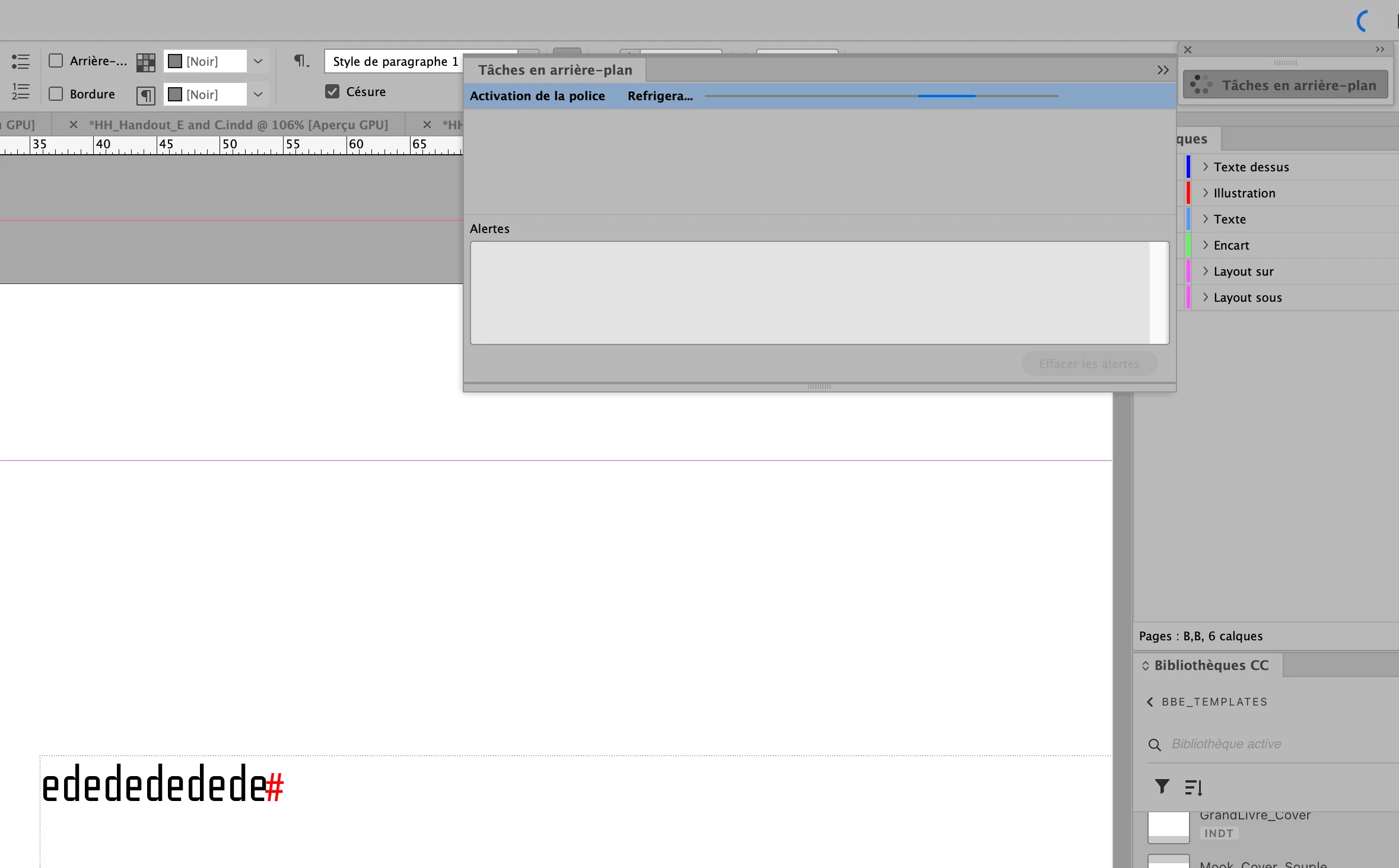

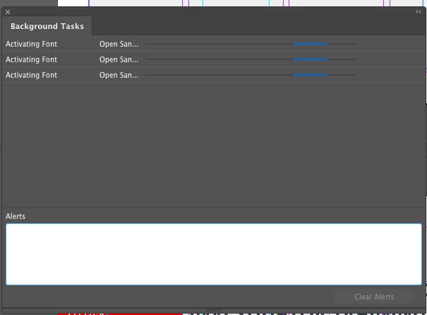

My adobe indesign keeps working in the background to actiavate fonts, going on 3 hours.. anyone else having he same issue?
Correct answer Kevin Stohlmeyer
Looks to be ok on the server end: https://status.adobe.com/creative_cloud#
Have you tried restarting Suitcase? That would explain InDesign if your font manager is hung.

Sounds like Font activation is a well know issue.
I'm having issues with Font auto-activation and need to restart ID in order to get it right
The weird part is that the wheel keeps spinning but the Font is available. The down part is that I can't export any pdf as the Font activation task has to be completed to allow further tasks to be done.
It'll be great if ID could have a fix on that.
July 15, 2021
My workaround for CreativeCloud fonts is to turn off Adobe Fonts in the CreativeCloud app in Preferences under Services and then turn it right back on. As a result, the fonts are then activated immediately. I work with Mac OSX BigSur and FontexplorerPro as font management.

Yes, I'm experiencing the same problem since a couple of weeks/months (can't really remember when it started.) But it seems to be everytime I open a document that uses fonts that I selected in my Suitcase Fusion (21.1.1) but clearly are also available in Adobe Fonts. Instead of activating the Suitcase version it tries activating the Adobe version but that doesn't work so it keeps activating in the background... Really annoying. But is it an Adobe or Suitcase problem? I haven't given Indesign hte OK to activate the font, it starts doing this by itself???

No offense to Extensis, but it is always usually a Suitcase issue.
Auto activation bypasses your manual activation - if the font is needed in the document you are opening, Suitcase should auto activate the font and make it available in InDesign. The whole point of the feature is that you don't have to give ID the OK.
If you have Adobe Fonts active, it sounds like there is a syncing conflict between Suitcase and ID. Either way, they should auto activate without needing to hit OK - there may be a slight delay but they should drop off your missing font window.

the issue just stop, also now see in my suitcase fusion that adobe fonts are loading. maybe an adobe servers issue.
JonathanArias
July 15, 2020
yes, i did, it fixed the issue, however, i now have a co-worker with exactly the same issue
