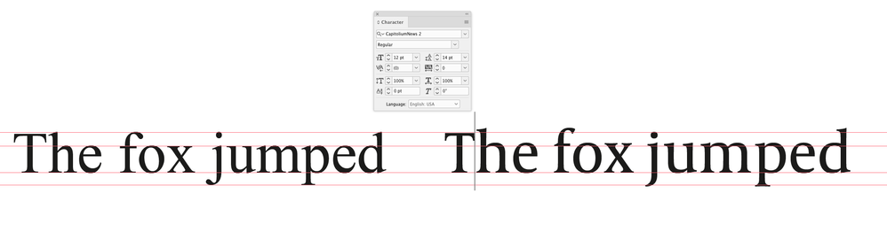

The difference is mostly in the x-height. If I set all caps the cap heights are the same. News has less contrast so it will hold up better under variable printing conditions.
The font’s x-height affects how it sets. This text is all 12pt:

Just realized in my earlier comparison post I was showing Capitolium 2. The Capitoleum 2 News version has a larger x-height, so upper & lower case settings might appear visually larger when compared to a font with a smaller x-height. Gerard Unger is a highly regarded type designer, so I assume the News version has a larger x-height for legibility at smaller point sizes and the poor printing conditions.
Point size is measured from just above the ascenders to just below the descenders, so fonts with larger x-heights can appear larger at the same point size.
Why don’t you just ask the designer to set the text smaller, or use the Capitolium 2 version?

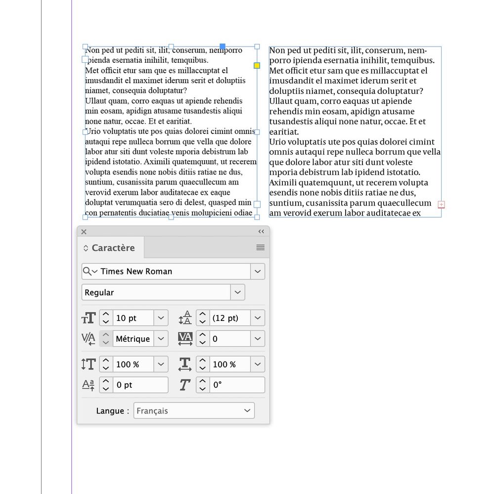

I also find that CapitoliumNews 2 seems huge compared to Times using the same size.

The x and cap heights are virtually identical.
12pt:
