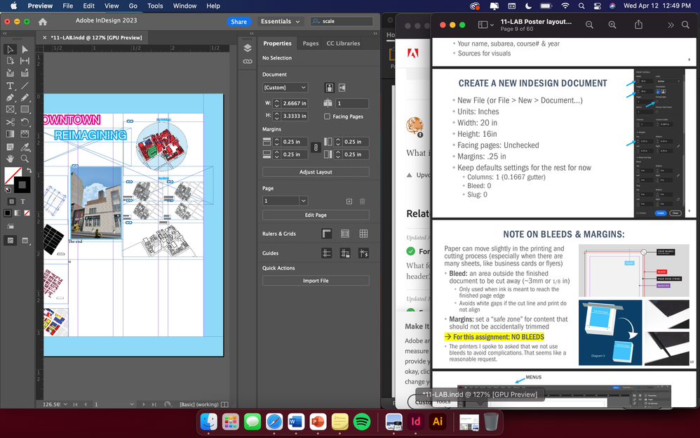

Hello, I am working on Adobe indesign for my university course making a demo-poster of my work during the semester. My professor included instructions on how to add a text box and that the requirements must have 14pt minimum, serif or sans serif and she also recommended to widen the linespacing to feel less cluttered.
As you can see in the file that I provided below, my font size is set to 14 but the font appears to be jumbo sized (not "downtown reimagining"- this too is the incorrect font as it is set to 10pt). I just want to know how to fix this issue, also I read that I can scale my text but do not know how to confirm if it was done properly. Also my scaling preferences in the general setting are... (scaling is applied to content)
FYI if I get a response past 11pm it will be too late as it is due.

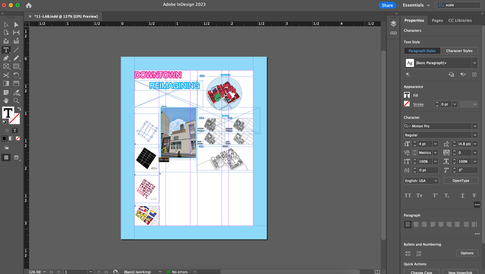

I should also mention that this is my first time using Indesign so I may be a little confused about how to check for these things.
When you say check to see if any Character Styles are applied to that text, I would thing they are because isn't that what makes you change the text font, size, and spacing?
Also, my Paragraph Styles are basically set the same as the Character Styles. I can include a few other files showing the options I have checked off.Screen Shot 2023-04-12 at 12.33.57 PM.png
Apr 12, 2023 Apr 12, 2023
Okay, see the + sign at the end of the Character Style name? That means its been modified. In skilled practice, you should never see this marker, because every change should be associated with a fully updated Paragraph or Character style. You NEVER use spot formatting (grab some text, apply a change) in InDesign.
So select the paragraph that's not what you want it to be, and if either the Paragraph or Character Style name in the list has that + marker, right-click on it and click Clear All. That will reset the style to its definition and take away anything that was applied as an override.

Hi @Amanda29370280gx9f , Looks like your ruler units are set to Inches and the page size is around 2.75" x 3.25", so relative to the page size your 14pt text looks right.

The instructions say to make the page 20 inches x 16 inches, but according to your properties panel, your page size is 2.6667 x 3.3333 inches
That's why your text looks large: your page is small
Here is my 14 pt text next to yours on the page set up as 2.6667 x 3.3333 (mine's in green)
Fix your document size, and your text will show up in the proportion you expect to see.
-- It looks like you originally set your page size as 16 x 20 picas. That would give you the 2.6667 x 3.3333 inch page size that you ended up with. The new doument dialog defaults to picas for some reason, so it's easy to see how this could happen to a new user.
Good catch. šŸ™‚
I'd say the page was set up using picas, not inches. 20 picas = 3.33 inches.
InDesign is very flexible with its units management. Always make sure you're using the right ones. šŸ™‚ (Hint: Picas are the pro measurement, but you will probably want to stay with inches to stay in step with your class.)
