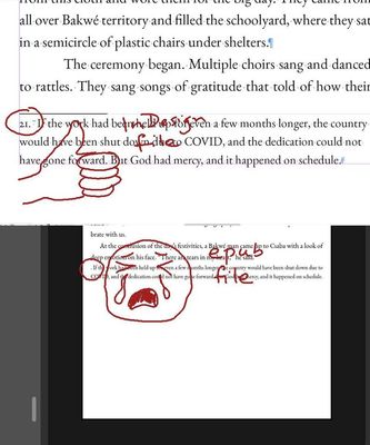

I'm exporting from InDesign to epub, and a file that's been exporting OK suddenly loses all of its footnote numbers (not the reference, but in the notes themselves) in the epub. It has happened in more files than I care to count. This is a recurring issue that I'd really like to find a solution to. So far, the only thing that's ever worked is completely rebuilding the file, which is seriously no fun.

And...reflowable layout. I have a simple superscript style applied to references. I don't know what else to check, options-wise...nothing looks wonky to me.
