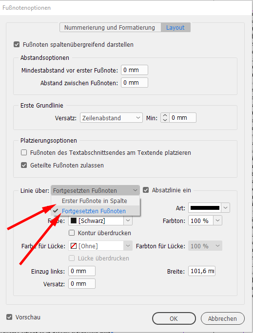

Here a screenshot from my German InDesign showing the Footnote Options > Layout tab:
As you can see Rule Above ( Linie über: ) has a dropdown for Continued Footnotes (Fortgesetzten Fußnoten). Same options are available with First Footnote In Column (Erste Fußnote in Spalte).
