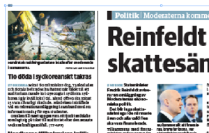

That still leaves the issue of the additional margin. Here's the problem:
This is what it looks like when I try to use the box coordinates extracted from the placed file, offsetting them by the difference of the geometric bounds. As you can see, the boxes are somewhat off to top left.
This is what happens when I place the PDF used above in a new document, using the default Crop to bounding box (visible layers) option. Apparently InDesign does not crop to the exact bounding box of the items, but adds a bit of margin for some reason. I haven't verified this yet, but it looks like this margin is the same as the offset I get above. And if you are wondering why the columns in the PDF appears to be swapped, the document above has placed the same PDF twice with different X offsets to get that effect.
Any idea?
