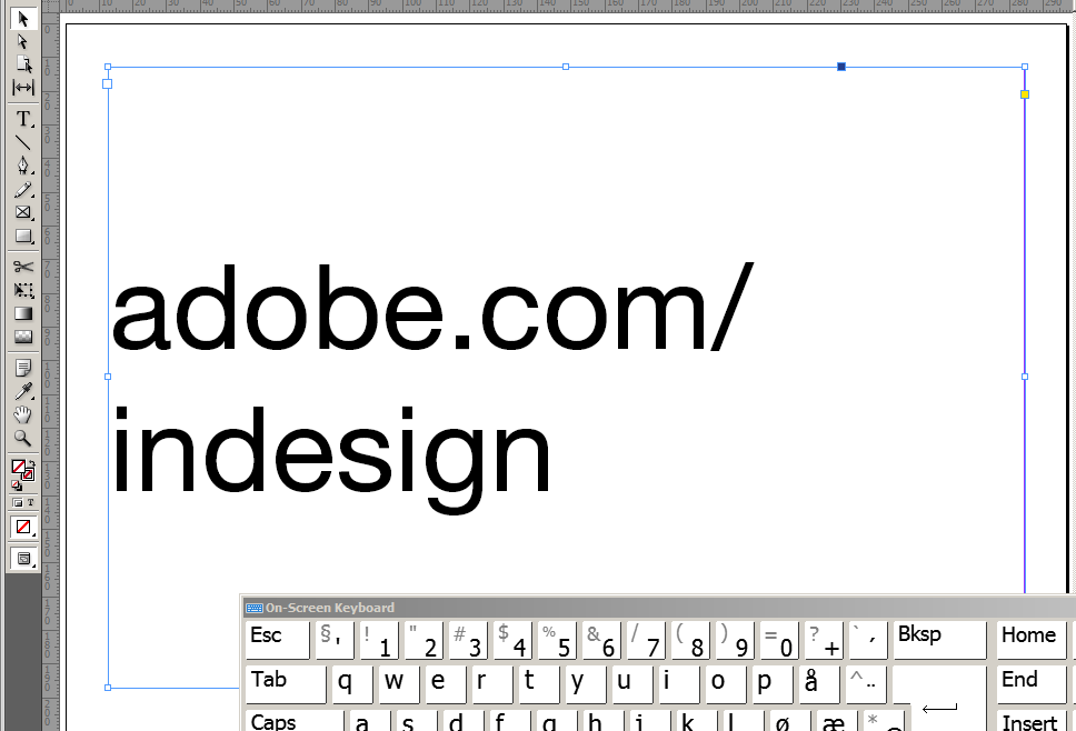

    The Golden Ratio is not a Golden Rule, but more of an advice. It deals with proportions between text and margins, and so one would assume the page orientation does not matter.
    I don 't think the Golden Ratio is the most important thing in the world -- there is no reason to assume *everything* in print should abide by it. You are correct in your observation. the examples only show pages with plain text and headlines, that is where it's ar it best (for whatever value you like to assign to "best").
    Your poster looks fine. For such a large white space, I would center the text block both horizontally and vertically; it's hard to see on your image, but it *looks* to be slightly off in both directions. Alternatively, you could move it vertically off the center, not by a small amount but by a lot (as they say, "piss or get off the pot! (well, some people I know would say that)).

    You sure we don't need to grid this though? I tried Text Frame Options => Vertical Justification => Align: Centre - but it leaves a lot to be desired, and I feel the line-height between "adobe.com/" and "indesign" could use more order and harmony with its surrounding spaces. I'm also thinking of adding a disclaimer to the footer.

    If you do draw a grid (or at least 2 horizontal lines, dviding the area into three equal strips), you will see you must not rely on "Vertical align to Center" for such a job! First off, it has four different settings for the top offset (Leading, capitals, x-height, Ascender) -- which one is used? Second, it depends on whether you want "use" the tops of characters -- in your example only the "d" and "b" stick out -- or the top of the lowercase characters. Align them by eye and step way back from your screen to get a visual impression.
