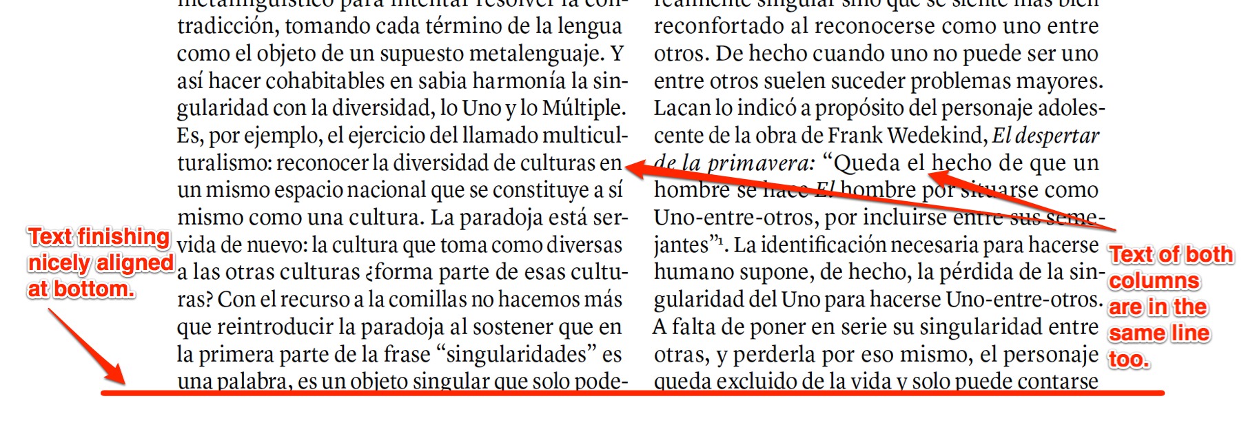

SAMPLE 1
All text fitted on baseline grid

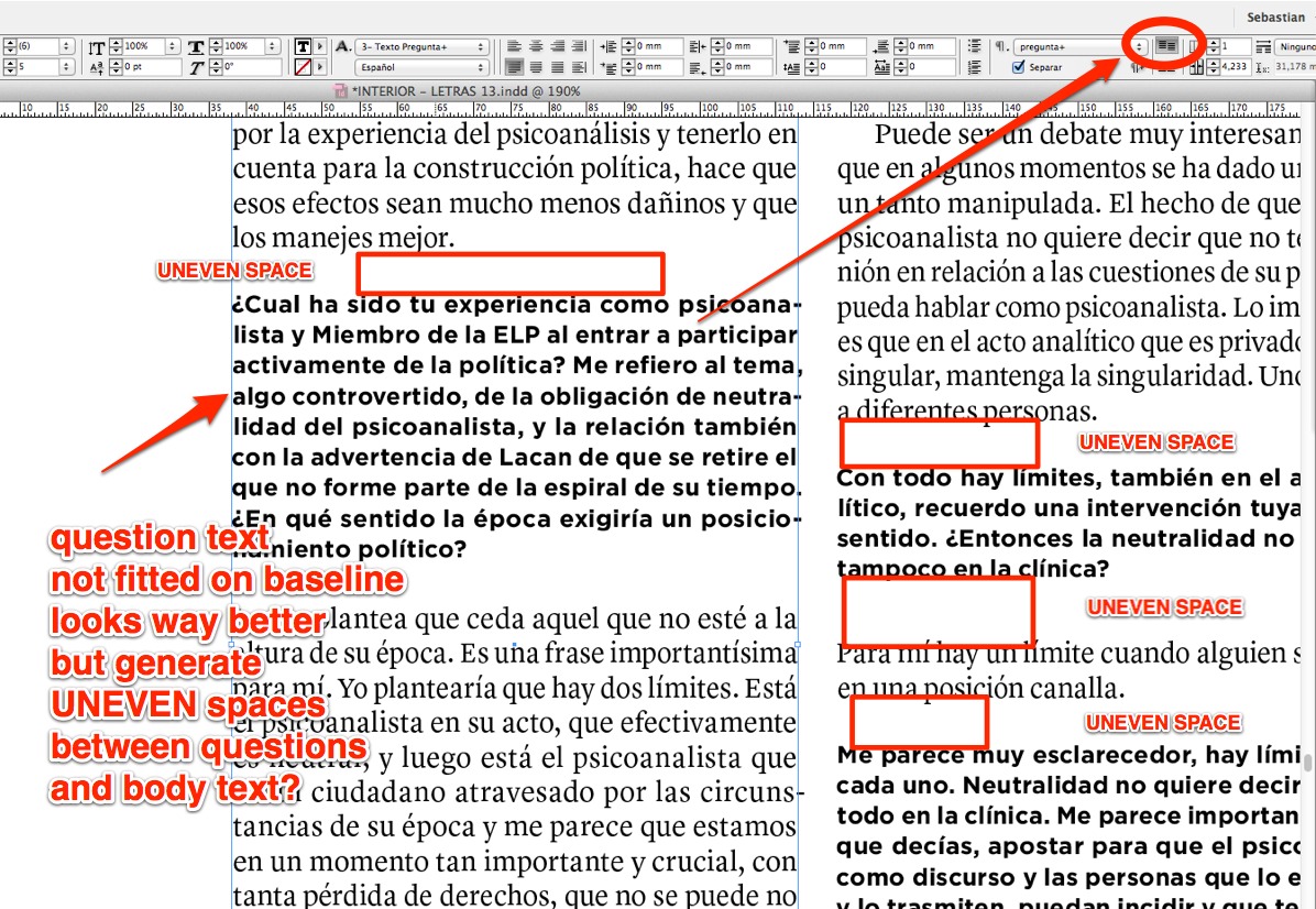

SAMPLE 2
Question text not fitted on baseline grid. Answer text on baseline grid.

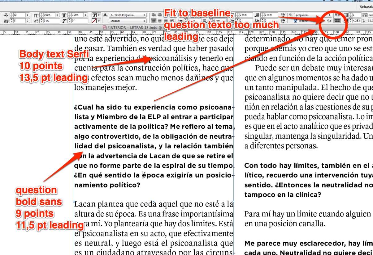

just in case the image don't read well this is the text there
Answer text is
10 points serif / 13,5 pt leading
Question text
9 point bold sans / 11,5 leading
If i fit everything to a baseline the question text leading is too open. If i take the question text out of the baseline grid if will generate uneven spaces between questions and answer.
Is the any way to solve of improve this design with baseline grids?

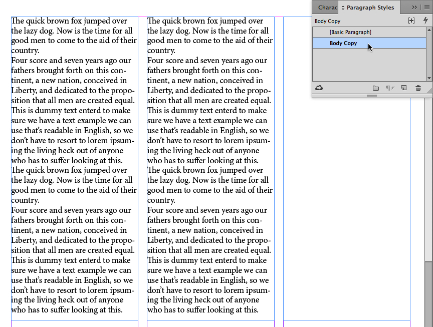

But if we could determine a consistent minimum leading value, the key is designing slugs of larger, display type in multiples of that minimum leading value. Let's use the example below, starting with three columns of type using a Body Copy style of Minion Pro, set at 12 points on a 13.5 point line (12/13.5).

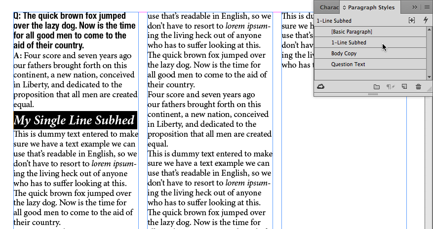

Now we'll create a contrasting Question Text, set at Helvetica Bold Condensed, set 12.5/13.5. The type looks different, but the leading remains the same. So all the lines, well, line up.
