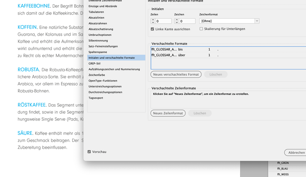

Community Beginner ,
Feb 24, 2023 Feb 24, 2023
Thank you very much!!!
That was my fould: ....  trough 1 Word
