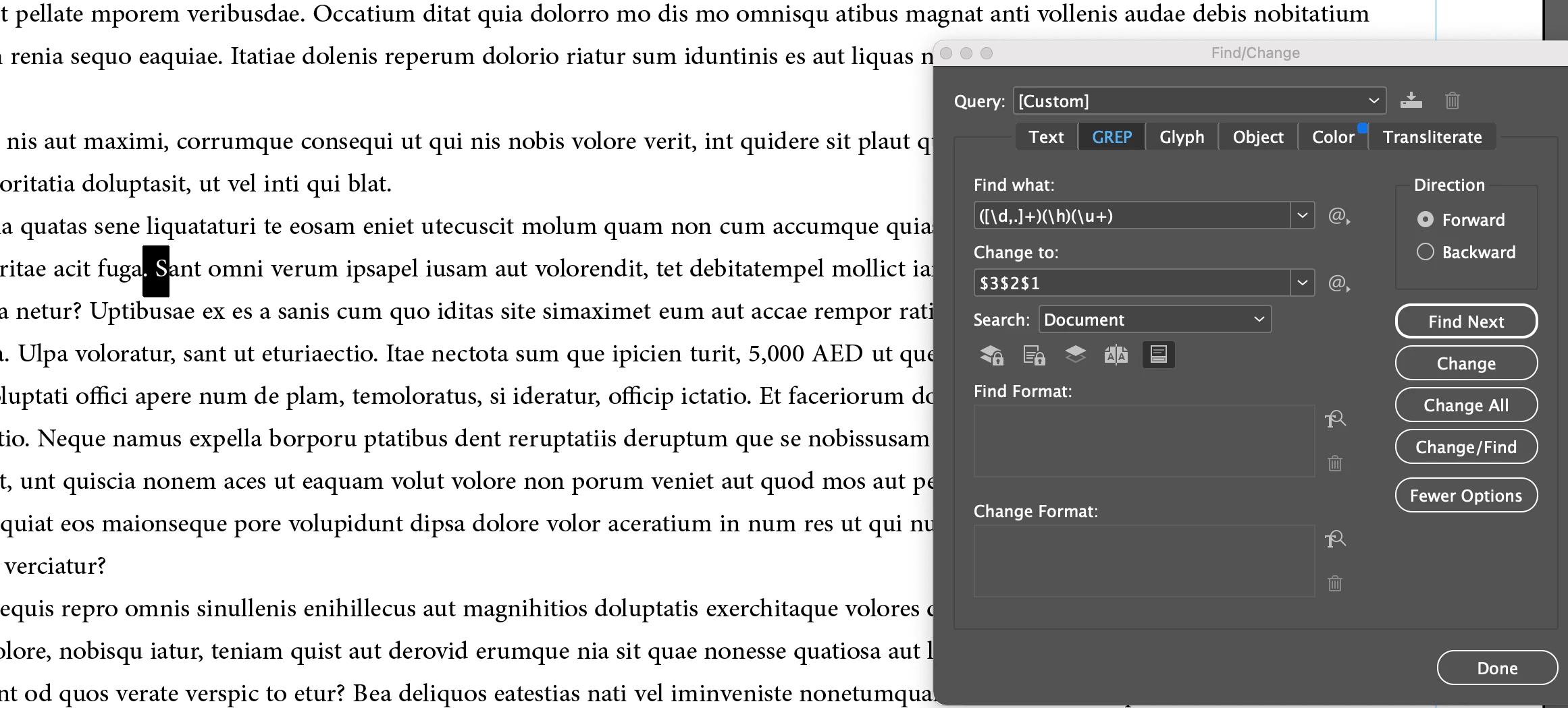

It did not work Jedi
Now it's finding only capital letters at start of paragraphs 🙂
Guide ,
Nov 22, 2023 Nov 22, 2023
Are you sure?
Capture d’écran 2023-11-22 à 13.24.58.pngCapture d’écran 2023-11-22 à 13.25.14.png
Participant ,
Sorry it works, but it's finding only capital letters at start of paragraphs as well.
Guide ,
OK!
(\d[\d,.]+\d)(\h)(\u+)
Participant ,
Thanks a lot!
