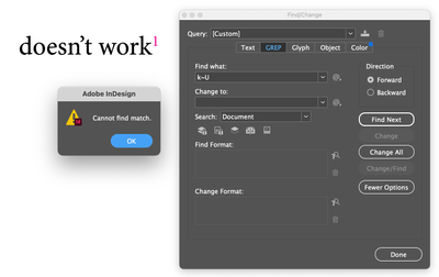

Hi @James Gifford—NitroPress, I wonder if you have run into a bug?
FindGrep ~U works fine:
But I get strange behaviour when I search for a character before the endnote ref, eg k~U:
Can anybody reproduce my test? If this is truly a bug, then it explains your difficulty!
- Mark
EDIT: I found something else:
k\x{0004}
This works, ie finds "k" and then the endnote symbol (unicode 0004). So I tried to do the normal grep via the UI but now I cannot do a capture group replacement with it. Using a lookahead, eg.
\s+(?=\x{0004})
 worked, and targeted only the offending space(s), but I couldn't remove them or replace them (the replacement just didn't happen, with no error). This behaviour might be part of the bug.
Peter Kahrel
Aug 26, 2024 8:32 AM UTC
Indeed, ~U doesn't like lookarounds very much.
m1b
Aug 26, 2024 11:06 AM UTC
Yep, I found the bug report. Only has a hand-full of votes, so please vote if you can.
