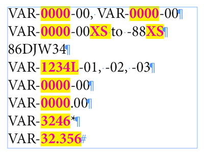

I am currently trying to format some numbers in a table. I am doing this using GREP in a paragraph style that's applied to the numbers. My problem is that the numbers have so many special situations.
The goal is that the numbers I marked blue in the screenshot do not have to be formatted manually anymore.
The bold parts of the numbers are already being formatted with GREP.
Currently, this is the code I tried for formatting the blue numbers.. but it is not working.
(?<=-)(\d{2,3})(!\d)(!\.)
Arguably, my GREP skills are not that great.
Do you guys have any ideas what I coud try?

Your sample looks like "select any two digits that are preceeded by either a period or dash, and that are not followed by additional digits". Your regex seems to imply that you'd take any two or three digit number, right?
(?<=\.|-)(\d{2,3})(?!\d)
First: a positive lookbehind, "capture anything that follows a literal period or a dash".
Then: a group of "any two or three digits".
Followed by: a negative lookahead, "don't capture anything that doesn't precede a digit".
There weren't any three-digit valid groups to be captured in your sample, so I'm not sure why you need that, but I made some "-00XS to -999XS" examples to make sure this regex caught 'em.
Mar 18, 2022 Mar 18, 2022
Sorry, I had some copy-paste confusion over here, my previously posted negative lookahead is incorrect.
This matches your sample but it feels wrong, somehow:
(?<=\s|\.|-)(\d{2})(?=,|\>|\u)(?!\.)
It finds two-digit numbers preceded by whitespace, literal periods, or dashes, and followed by commas, uppercase letters, or end-of-paragraph locations, but not when follwed by periods. Even though your attempt at a regex included three-digit numbers, I've excluded them here because your sample doesn't include any three-digit numbers to capture.

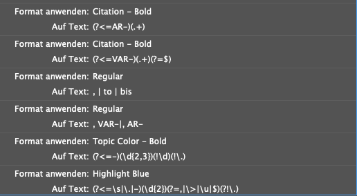

I really don't know why the code is not working, I even tried it in a second, new document but it still does not catch all of the numbers it should catch. Can you show me a screenshot of your GREP window?
Here is what mine looks like, I hope none of the other GREPs are interfering with this one.. but even when I delete them, it still does not work.

That is actually what I am doing right now.
This is how all of my GREPs for these product numbers look like:
(The AR numbers are also used sometimes, although not in the examples I posted here)
