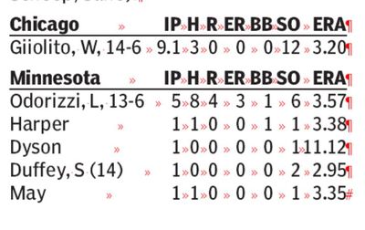

I've exhausted my guessing and pecking at this.  Can someone show me how to catch a range of AND's essentially to grab the second line of this linescore.  I got the first line because it is static.  Thank you so much
Chicago IP H R ER BB SO ERA
Giiolito, W, 14-6 9 3 0 0 0 12 3.20

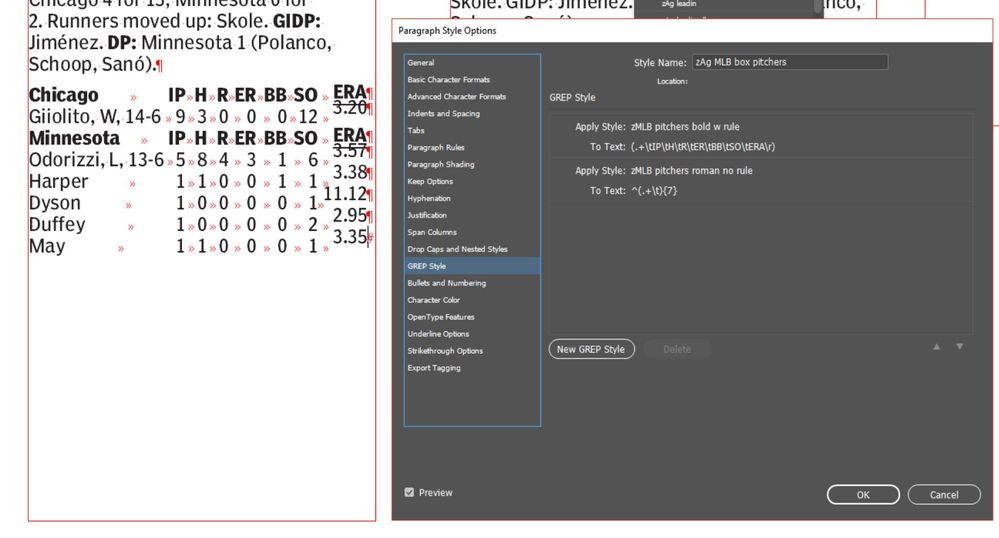

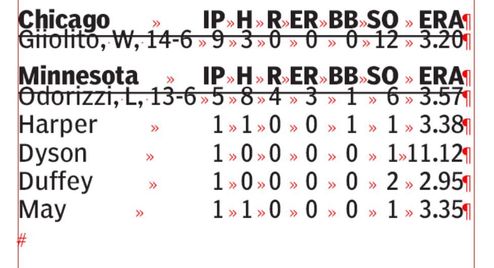

    This is the result when I apply that GREP style.  The GREP style above calls a bold character style that holds an underline and a baseline shift of -2 pt.  Then it is back to roman and a baseline shift of -3 pt trying to find the rest of the pitching lines.

    IMO, you shouldn't bother with baseline shift in a such layout. Take time to fix your styles: return baseline shift back to normal, adjust leading and space before/after. I'd also use Paragraph rules instead underline.
    EDIT: and don't use Char style for the whole paragraph, it's a no-no, too…
