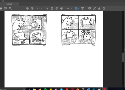

I made my booklet perfectly fine and this is printing correctly in terms of how it flips when printed double-sided, etc. My problem is I want to double up as I made it half a page size. How can I print that way without having to manually flip the paper after one print?
Here is the layout for reference. Each page is 1/4 of an 8.5 x 11 page (4.25 x 5.5).
Edit: To clarify, the booklet format is correct. I just want to optimize the exported PDF so that I get two of my booklets each time I print this layout. Here is what the PDF looks like when I export it now with the current settings and page size:

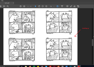

And this is what I want it to look like:

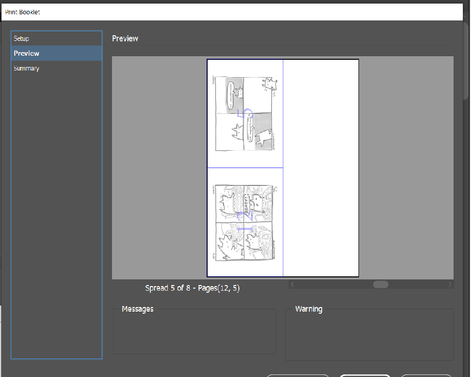

Here are my current "Print Booklet" settings on InDesign:

Yeah, I don't think this is my question. I have pages that are 4.25 x 5.5 inches and so the booklet layout is landscape and fills half of a letter. I designed it this way so I could optimize my printing and get twice as many books per page. But the problem is when InDesign exports the booklet to PDF it won't let me do twice as many, so I would have to physically flip the paper after printing if I want twice as many.
I could manually edit them using photoshop but I'm hoping there is an easy fix to allow for booklets this size in the future to be expected as multiples per sheet.
To clarify, I don't want to booklet to span less sheets by doubling up, but I want two of the exact same booklet per print.
Here is an example of what one side would look like when I go to export it as a pdf:

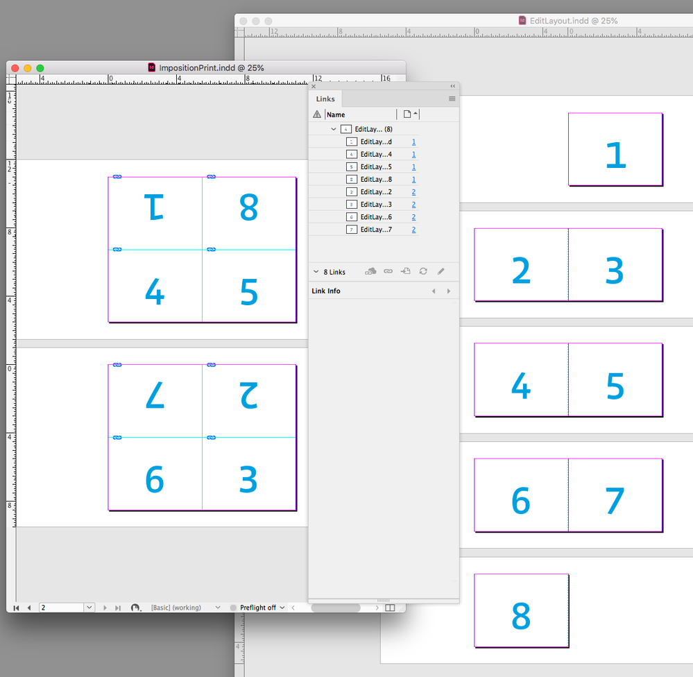

Print Booklet is limited to 2-up impositions. There are more complete imposition alternatives, but they usually are not free.
You could set up a 4-up impositon document, and place your reader document’s pages into the imposition document. This is a 4-up imposition guide for 8-pages. Place your 4.25" x 5.5" pages on the imposition document’s 8.5" x 11" page in this order front and back:

and manually duplicate each spread to allow me to optimize each sheet, but I still wonder if there is a way to do it while keeping the original page size.
Creating a imposed print document would let you keep the original page size. You would be placing the original pages into the imposition document, and the original could still be edited—it would be just a matter of updating the links in the imposition document before you print. You wouldn't use Print Booklet, you would print from the regular Print dialog
Jan 30, 2020 Jan 30, 2020
Something like this:
Make an edit to EditLayout.indd, and it gets updated in the imposition
This is a 4-up imposition where the sheet would get folded twice and trimmed. If you need more than 8 -pages the imposition document could be rearranged as needed.
If you don’t want to fold 8 page signatures twice, and would rather trim the spreads apart first, then something like this for 12 pages:

I appreciate your reply. I don't think your problem is exactly what mine exports as? Here is what my PDF export looks like when I export the booklet from InDesign:
And this is what I WANT it to look like when I export:
So the booklet layout stays the same (because it works fine and all the sides are correct when it is assembled), I just want to double up so that I'm getting 2 booklets each time I print my layout.
