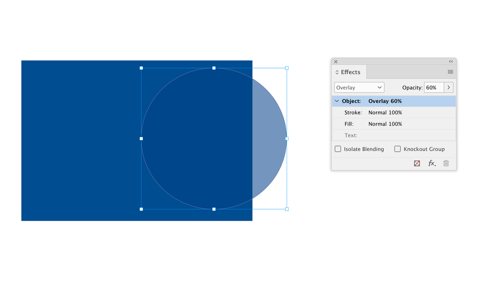

Hi @Kathy5FF7 , Blending Modes work differently depending on the chosen Transparency Blending Space in InDesign, or the Document Color Mode in Illustrator. Looks like your the way it used to be example is RGB and the other example is CMYK
CMYK Transparency Blending Space :

So it turns out that I was unaware the original designer had uploaded an RGB file (he didn't know either), and not the CMYK that was saved on our server, so I wasn't thinking of the RGB/CMYK issue. Thank you @rob day for your reply! Mystery solved!
