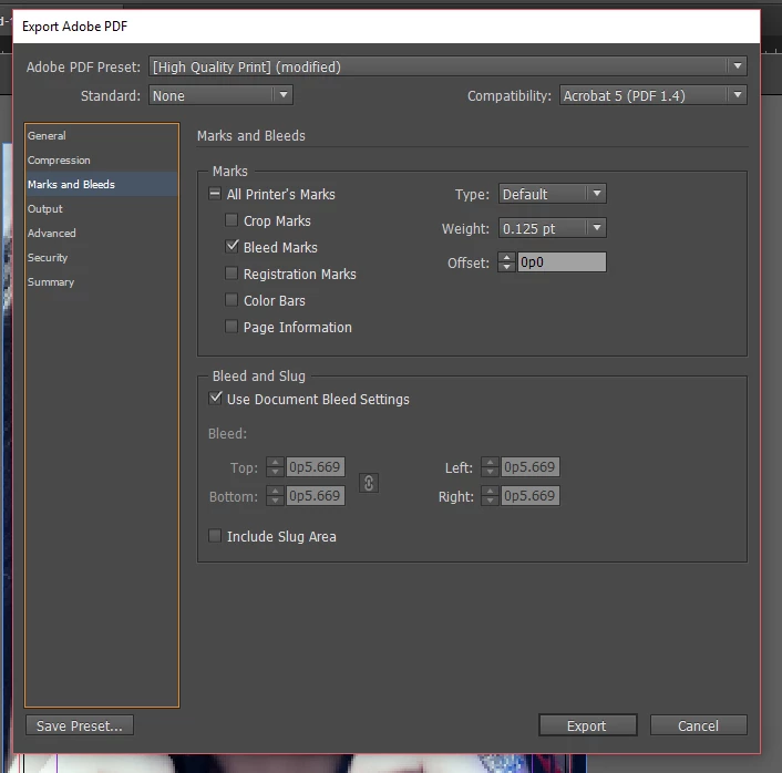

These are my current settings:
WIDTH 49p7.276 (AUS A4 size)
HEIGHT 70p1.89 (AUS A4 size)
Bleed: 0p5.669 As instructed by publisher. Left, Right, Top Bottom
Slug: 0. she didnt mention this
MY CURRENT EXPORT SETTINGS:

Here is the Indesign export PDF dialog - note the offset setting of 2mm - that is the distance away from the trim that the cropmarks will draw.

Selecting bleed on your output settings is correct, but Indesign won't generate the bleed for you. You have to make sure that you show the bleed area in your document (ie make sure you're not in preview mode). The bleed area shows as a red line outside the boundary of your page, and your image must be large enough to fill that area.
Sorry - just noticed that you don't have crop marks selected in your output dialog. The marks that you see are actually the bleed marks which are not necessary. Switch off bleed marks and switch on crop marks and you should be good to go.

I did what you said Malcom thanks. I turned off the crop marks and put the bleed marks on, however it still looks exactly the same? the publisher insists that I have it the same as the example she gave me. These are the instructions she gave me about how to set everything:

"The bleed setup is correct but the cropmarks are too close to the edges, need to be at least 2mm away from the trimming edges.
If it’s not possible, please remove it altogether"

THANK YOU THANK YOU!!!!!! It worked you were right, I had to make the offset 1mm less than the bleed, makes sense now! she didn't explain it to me and mentioned nothing about the offset.
