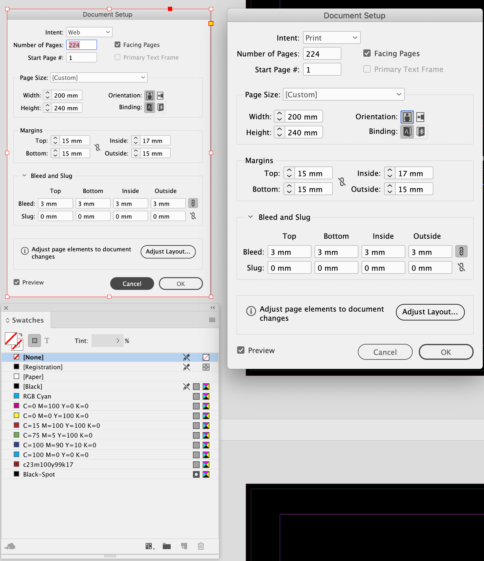

Enthusiast , Dec 11, 2018 Dec 11, 2018
The current is selected with red frame, on top is when I change, so I entered to correct measurments and it looks fine.

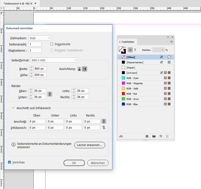

you changed the intent of your document from Print to something else, Web or Mobile.
Go to Document Setup and change it back to Print.
From my German InDesign, Document Setup with Print Intent ( Zielmedium: Druck )
Document Setup with Web Intent ( Zielmedium: Web )

so show us your current Document Setup where you are seeing the RGB swatches.
Note height and width of the pages setup there.
If you change to Print Intent do the same values and meassurement system for width and height.
Hope, you did not change page sizes with the Page Tool or that there are any Alternate Layouts.
That would complicate the matter a bit.
Uwe
Thank you,
I will now have to go through the doc to make sure it didn't change.
I still don't understand how it happen, but I'll make sure to pay attention so if it's a bug I will be able to report it.

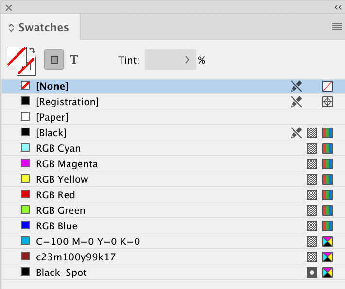

By the way, look at the swatches, all changed to CMYK, but the "RGB" Cyan name didn't changed...
The rest did.

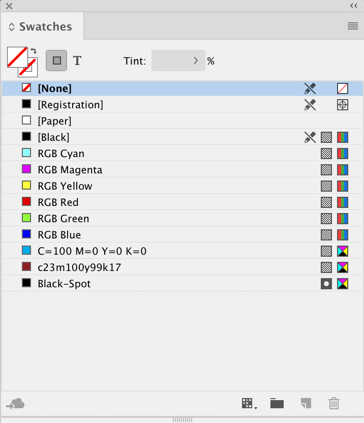

Look how it looked before:

You could try to edit your left over "RGB Cyan" swatch.
