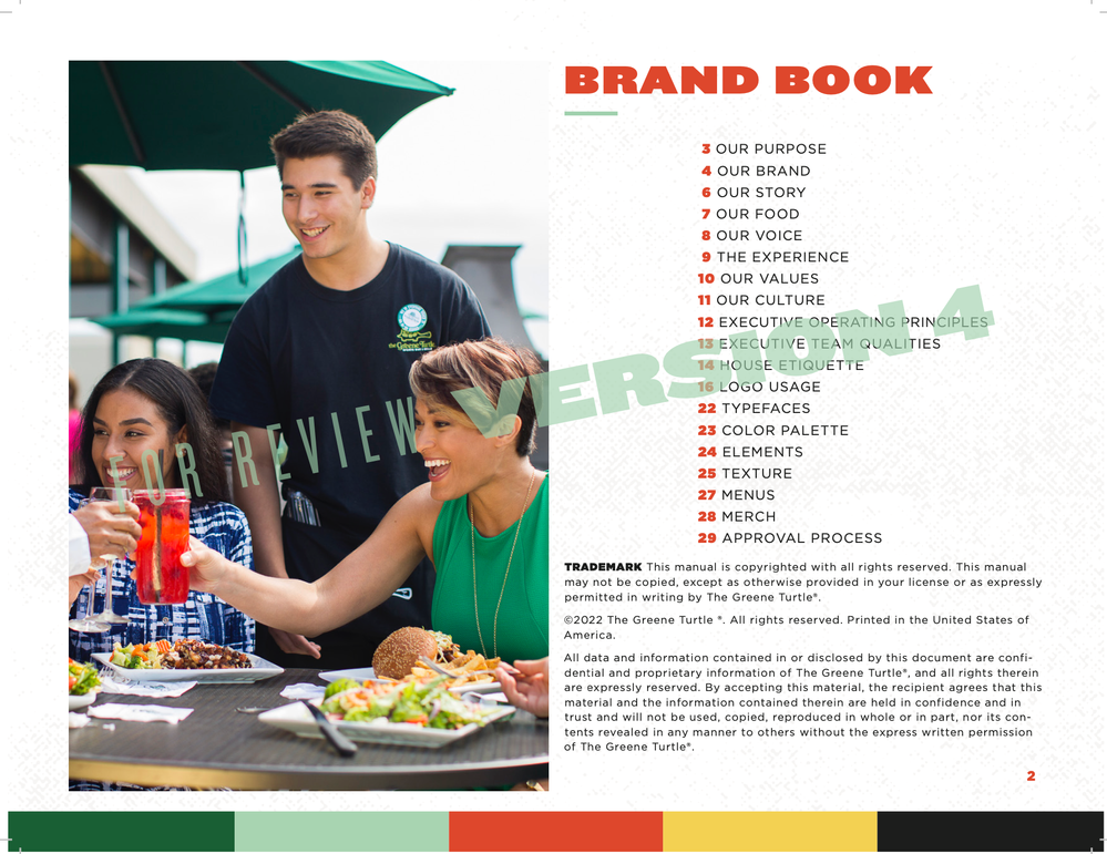

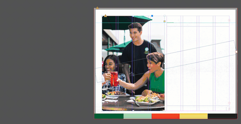

I was opening up an Indesign file that I am working on and all of my text is not showing. It is just showing the box with the red plus. I have not edited this file in a while and this is not how I left it, so I am not sure what is going on. This is very important for work so I need a resolution ASAP! ThanksScreen Shot 2022-07-26 at 10.55.07 AM.pngScreen Shot 2022-07-26 at 10.58.22 AM.png

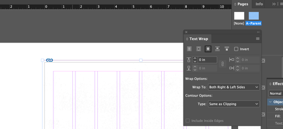

Looking at the top screen grab it looks to me like there is some sort of linked object filling the enire page (chain-link symbol in the uypper left corner) which may well be the gray background. I'd bet that Susan is correct and text wrap is applied to it.

Aug 03, 2022 Aug 03, 2022

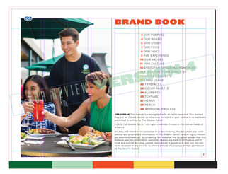

Peter was correct - it is a text wrap problem. There is an empty frame on the Parent Page that has text wrap applied. Delete that frame, and your text will all return.
Screen Shot 2022-08-03 at 9.38.39 AM.pngScreen Shot 2022-08-03 at 9.40.11 AM.png
