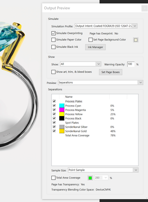

This is what shows up in my InDesign:

I believe I might have found the issue. In a resource I found, it said that the colors have to be set to NOT overprint.
When I uncheck, Simulate Overprinting, my document loses the gold and silver spot colors.
However, when I uncheck it with the working provided PDF the gold and silver stays present.
Unfortunately, I have no idea how this is achieved.
Explorer ,
Feb 13, 2022 Feb 13, 2022
When saving as PDF X-3 2003, the spot colors seem to start overprinting, which the original working example PDF does not seem to do. Which also makes the file show up as "Page Has Overprint: Yes"
When saving as PDF X-4 this effect does no longer occur. And the page shows up as "Page Has Overprint: No"
Also, when using CMYK as color profile for the Photoshop file, the identifier changes to FOGRA27 and the Output Preview show behavior becomes the same as the working example. I do have hope this may work, So I will file this version and cross my fingers while I pray.
