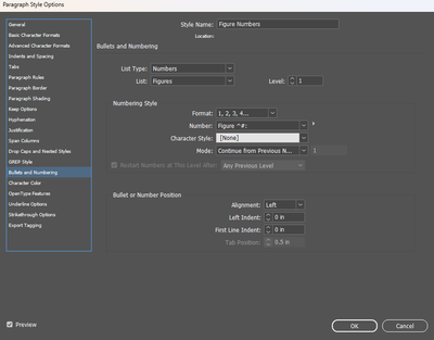

I was able to successfully input automatic figure numbering using a defined list and the bullets and numbering paragraph style. It works perfectly in my test document. However, on the actual document I am using it on, it does not number them in order.
So I'll start with the first figure and it's labeled correctly as Figure 1. But then, when I go to Figure 2, it suddenly becomes Figure 1 and the original Figure 1 becomes Figure 2. If I continue, even more figures are out of order in random ways.
I hope that makes sense. I've included pictures of how I have my style set up:
Thanks for any help/advice!

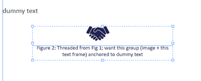

Thank you! That makes sense. Is there a way to simultaneously anchor the figure image + caption to text while having the caption frame threaded? Attached screenshot to show what I'm talking about.
Nov 04, 2025 Nov 04, 2025
One way is to cut/paste the images as inline images on an empty paragraph above each caption.
~Barb
