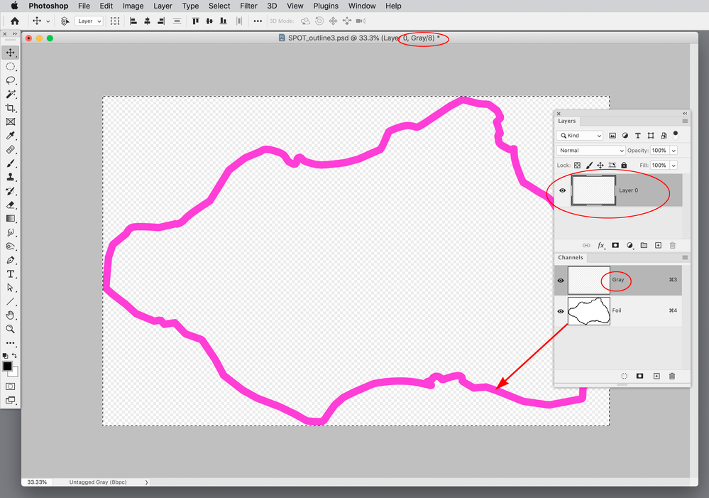

HI @garethrdwilliams , PNGs are always RGB only and can not contain Spot Channels, so you will have to Save As PSD. Is the shape defined as a Photoshop Spot Channel? Can you show us a capture of your Photoshop Channel panel or share the PSD file?
April 30, 2023

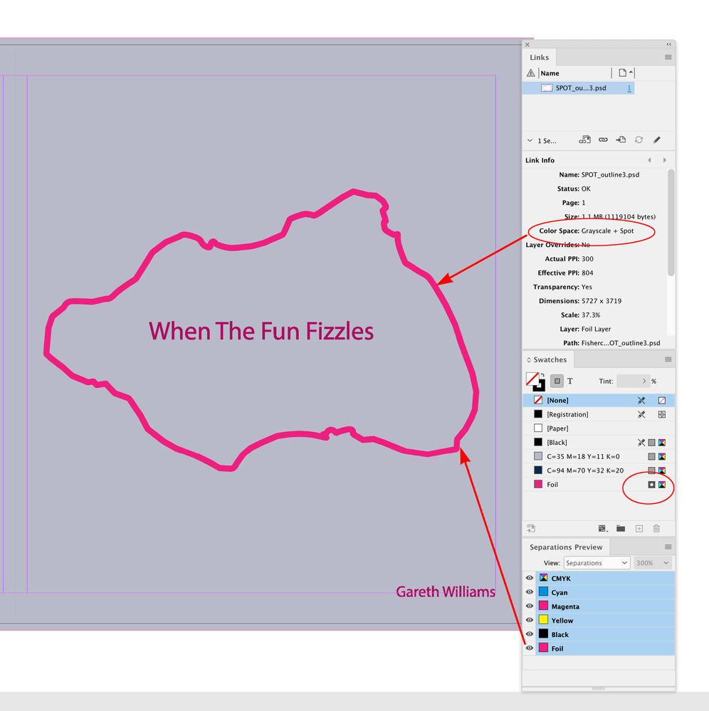

Thanks, this is the PSD file of the outline.
This is the printers website which outlines the way to upload:
https://mixam.co.uk/support/foil
Also attached is the InDesign file.

I supect all you need to do here is rename the spot channel in the .psd you uploaded to "Foil" to match the other spot color you defined in InDesign and remove the path from the Magenta channel so only the spot channel contains data.

As far as the spot color problem, I suspect the OP{ needs to actually create a spot color channel for the artwork on Photoshop, but we don't really have enough information about that file.
