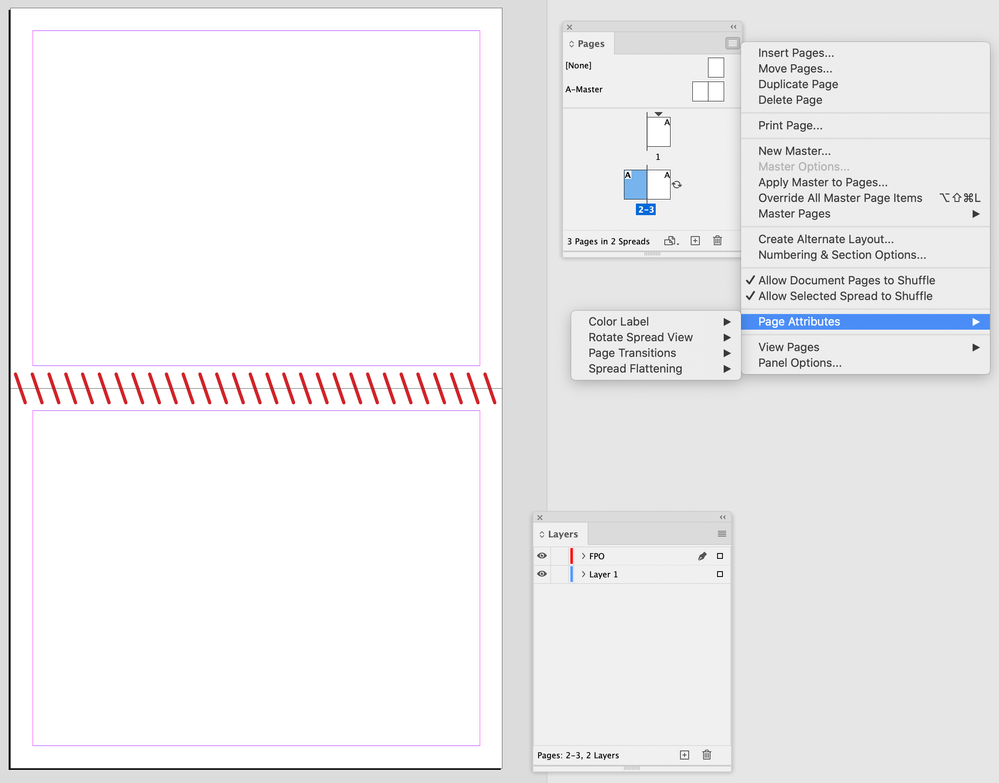

In the past, I have included a non-printing layer with lines indicating the spiral or wiro binding on the master page. It's a good idea to make a mock up of your brochure, to confirm the pages are in the desired rotation, particularly for calendars. You can also place your original InDesign file into a new InDesign file where you can rotate each page as needed before exporting to a new PDF. If you want to set up your file to show top binding, you can rotate the spread view in the pages panel. Here is a link to a related discussion:
https://community.adobe.com/t5/indesign-discussions/how-to-set-up-indesign-print-file-for-horizontal-document-that-binds-at-the-top/m-p/9057803

As mentioned by @Spenno - increase your top margin to account for the binding.
I'd leave it at that - I wouldn't rotate pages or anything.

I did calendars like this, which were landscape with coil binding on the top. I'd design everything the correct way up but rotate every even page 180 degrees in Acrobat, and have a slightly bigger top margin to accommodate the binding.
